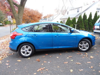

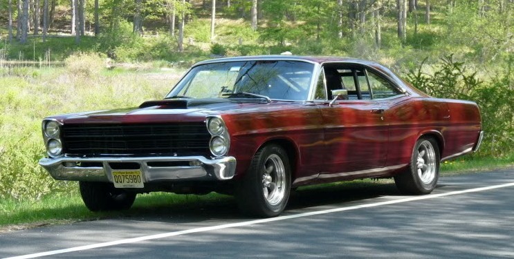

The issue is that I have two very different (and less than ideal) tow vehicles.
My 2012 Focus hatch with 160 horsepower and no tow rating. It does have the optional rear disk brakes and a manual transmission.
My '67 Ford Galaxie XL with 507 horsepower and obsolete brakes.

I've found that I should listen harder to those nagging voices in my head...the one that's suggesting you use brakes.
If there is no trailer rating for the Focus the engineers probably didn't add in any extra braking power. In order for us to have light cars they've been stripped down to bare essentials.
Add the brakes...

Your Focus was designed to carry maybe 4 passengers and maybe a hundred pounds in the trunk. So, maybe 900 pounds. Your car weighs about 3000#.
So total it's designed to stop 3,900#. Before you and whoever else goes camping with you and you load any stuff in the car your combined weight (1,300# trailer) will be 4,200#. More than your car was designed to stop. Then you add 4-500# of passengers and stuff and you're at 4,600#.
Lots of folks on the forum feel this is ok and have never had a problem. It only takes one problem before you wish you had brakes. I experienced a "problem" once (got out alive with no damage) and LEARNED from that experience that brakes are a must on any trailer I build.
Brakes cost less than two hundred bucks including the controller. CHEAP insurance.
