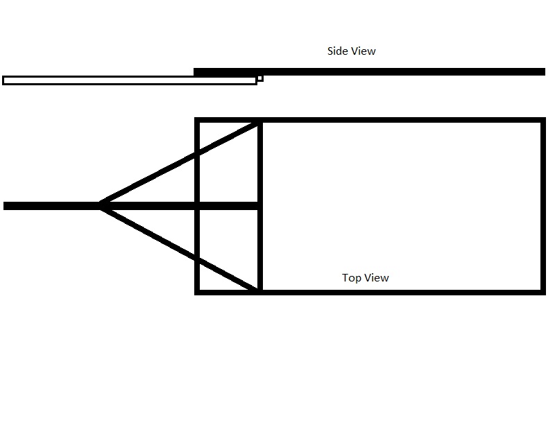

The NEWB is back! Now that you guys have got me pretty well straightened out on the whole axle/brakes issue (I think I'll be using a de-rated 3500lb torsion axle with 10" brakes), I'm working on frame design, and I need to make the frame and body of the trailer at light as possible because I'll be pulling with a wussy focus. It seems to me like the three easiest places to save weight in a TD are the frame, the floor, and the side walls. My sidewalls will be only an inch think (3/4 inch ply and foam center, and 1/8 luan skins). I may even ditch the outside luan skin and just cover the ply and foam in frp??? I have some ideas on the frame, but I was hoping you guys might help me fill in some blanks.
My idea is to do the outside rails of the frame in 2x2 angle, so that the wooden frame of the floor sits down inside the angle iron (if the floor is sturdy, should eliminate the need for too many steel crossmembers).
The tongue and the horizontal crossmember it terminates at would be 3x3 square tube and the two diagonal braces would be 2x2 square tube.
Here's a crappy drawing, but it is to scale somewhat. I'm shooting for 5-6 feet of tongue beyond the front of the frame. Is that enough or too much? The goal is to keep the overall length under 17.5' so that the trailer will fit into any garage that my Galaxie will.
Questions:
-Is this frame concept strong enough for a 5'x10' teardrop?
-What thickness angle and tube can I get away with?
-Will I have to beef up the parts of the side rail where the axle mounts? How?
-Should I move the crossmember further back?
Thanks,
Evan

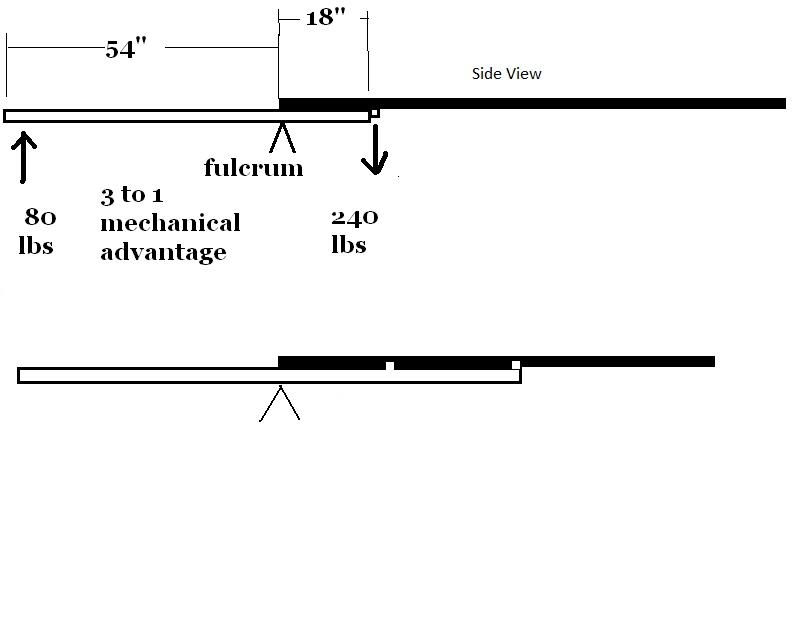

Postby bobhenry » Fri Feb 03, 2012 8:24 am
When I drew this I thought you said the tongue member was 6 foot.
When I reread it ,you stated it was 6 feet beyond the front member so my dimensions are off but here are my thoughts right or wrong.
A 1500 pound tear should have about 10% of the total as tongue weight as a rule ( not mine).
Thats 150 pounds ! My picture only shows shows 80 #
As the ball trys to lift the tongue weight see what happens at the other end. "For every action there is an equal and opposite reaction"

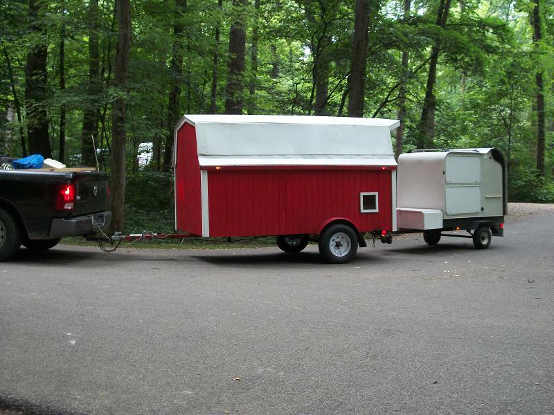

In this case we have introduced a mechanical advantage of three to one so our opposite reaction is tripled. I learned this lession with the barn build. The donor trailer had the single center member bent down almost 2" from the previous owner overloading it. I replaced the tongue on the barn trailer and went clear to the rear which let me do this......
and this! Note [ not legal in all states ]
In the bottom half of the 1st picture I have lengthened the under frame portion of the tongue to eliminate the mechanical advantage. The down force is now shared by 2 points ( the white dots) representing two crossmembers. I am hoping one of the engineer types can calculate the new downforce that these two members will face. I am sure its NOT 40# and 40# but more like 20# in the front and 60# in the rear but I can be way off base.
I know there is also some contributort strength added by the diagonals as well but that gets too fuzzy for my little bitty brain.
This is just my two cents worth ( and that is probably overpriced )

Postby Evan Gaffney » Fri Feb 03, 2012 9:18 am
I see what you mean about the leverage. I guess if the tongue is 5 or 6 feet, I'll shoot for 4 or 5 feet on the other side and then I'll weld extra good. The diagonals will be extended too, that way they spread some of the load to the outside of the frame and not just the crossmember.

Postby bobhenry » Fri Feb 03, 2012 9:40 am
I have witnessed the aftermath of two tongue failures and they
arn't pretty (and real expensive if you are on the road).
It definatly is not a place to scrimp by to save a few pounds.
