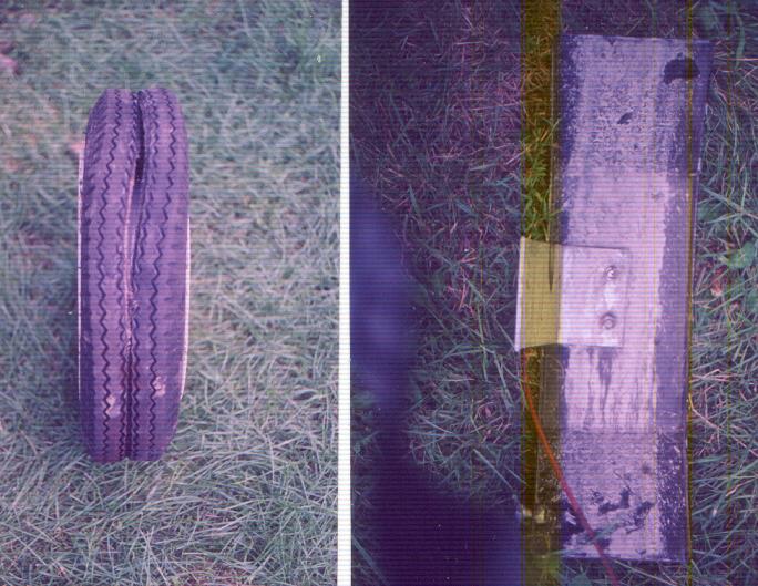

Warning the center bolt in the top of the fender will cut a tire directly in half if you get close to the total weight capabilities of the trailer. You might be better of removing them as I did.
