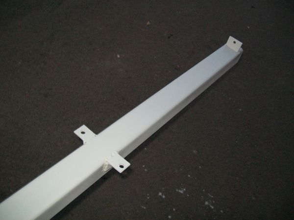

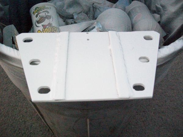

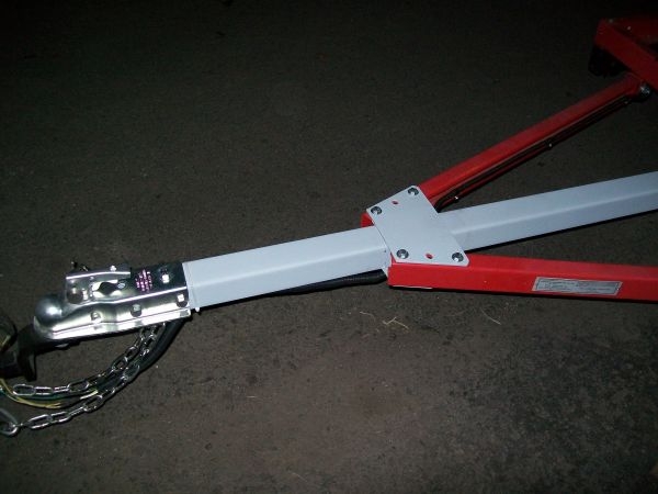

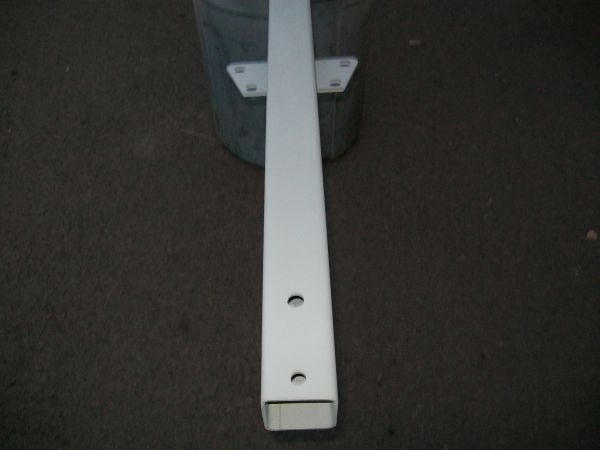

Hello Johnny B: I did the same thing that Zach did, but I used 2 1/2" x 2 1/2" x 1/8" square tubing. I reused the HF coupler and it bolted right on the new extension.
I took some angle and made some attaching tabs and welded them to the extension where they meet the cross members and bolted them to the cross members with 3/8" bolts into the existing holes in the cross members.
I cut the "box" off the upper triangle plate with a cut off wheel and flipped it over and bolted the triangle plate down over the new tubing. When it was all centered up, I welded the bottom triangle to the new extension.
The portion of the box that was still attached to the upper triangle is 2 1/2" wide and it sets perfectly over the extension and holds the tube in place. That way, I can remove the extension in the future if need be for some reason. There is no side to side movement this way. The upper plate sat about 1/16" higher than the A frame. The bolts pulled it down tight as they were drawn down holding it very firmly.
By doing this modification, I moved the coupler 24 inches forward from it's original location. It turned out great and it is stronger and much easier to back the trailer now.
