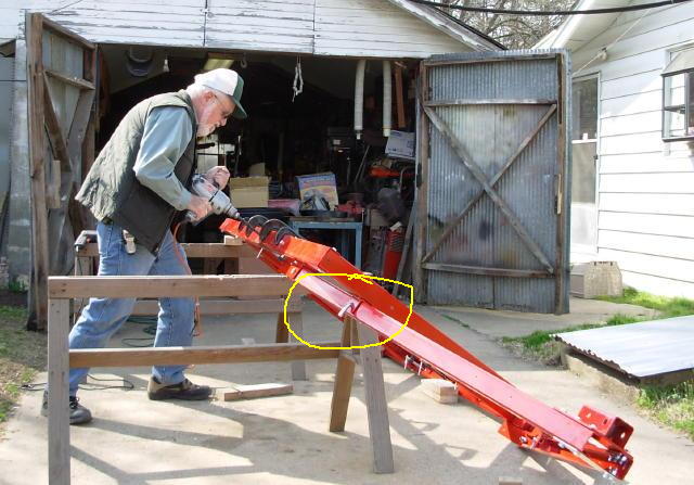

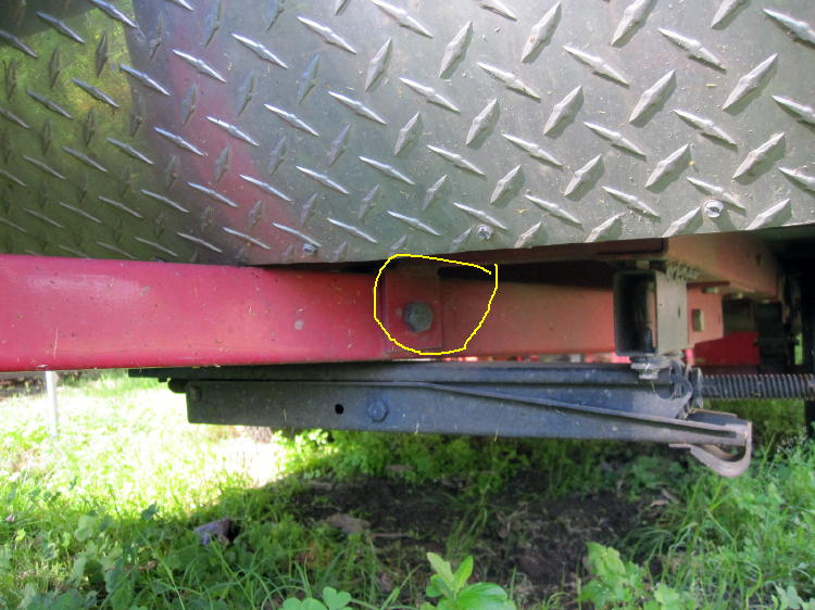

If you're using one of the HT 'Tilt' trailers, the noise may be coming from the 'latching mechanism' of the tilt part of the tongue 'A' frame. I have stabilizers on all 4 corners of my trailer but I often had noise when using only the tongue jack as front support so I replaced the pins of the latching mechanism with grade 5 bolts & 'nylok' nuts -

Re: Trailer sproing
Postby bobhenry » Thu Apr 05, 2012 11:52 am
I am betting on Harvey.
Mine rattled on the road. I finally welded them to shut them up once and for all.
