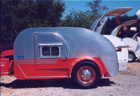

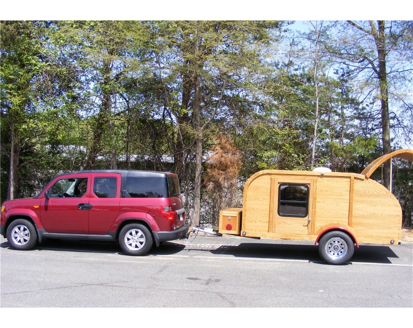

I'm starting to scheme up a teardrop that will be a 5x10 Benroy to tow with my Honda Element and I'm at the frame/axle stage. I've read through the excellent articles posted here, but I still have a question.
I'll essentially be replicating jfba's build (viewtopic.php?t=41159) but will be skinning it with aluminum. However, one of the things I love about the classic Benroy is the placement of the axle further back and how it is lower slung. You can see by jfba's that his axle is further forward with more clearance. I want more of a "squished"/compact version like the original, only 10' long versus 8'. jfba's is lovely, but it just looks too tall to me.
Was the original Benroy's axle improperly located? Is jfba's in the right place? Can I have a 5x10 ride lower than jfba's, or was he smart in doing that?

Looks to me like the woodie is just longer over all with the axle in the same relative position related to the front (i.e. tha galley sticks out further).
On the height thing torsion style axles can get you lower and you can also have the side wall skirt down further towards the ground w/o actully lowering the frame height. Stick with smaller diameter wheels and tires, too.

KCStudly wrote:Looks to me like the woodie is just longer over all with the axle in the same relative position related to the front (i.e. tha galley sticks out further).
It is in the same relative position to the front, but not the rear -- could the axle go back further like the classic Benroy (which is only about 1'-2' from the bumper). I'm guessing not as the tongue weight would be too high.
"Corncountry" built a similar design -- gallery/image_page.php?album_id=689&image_id=79394 -- looks like his is dropped lower too and the wheel is in roughly the same position. Keep thinking I should just drive out to Iowa and buy it . . .

Seek out Angib's trailer weight balance suggestions (I think there's a sticky near the top of the General Discussion forum). There is an excel spread sheet that let's you put in your known weights and locations of their centers of gravity to help calculate tongue weight. Most use 10-15% of overall trailer weight for recommended tongue weight, although Europe and some like to go lighter.
I just used the recommended rule of thumb
mikeschn wrote:According to teardrop rules of thumb (see outback.com) it should be 34.5 from the rear on an 8' trailer, and add 6" for every foot. So for your 5x9 it would be 40.5" from the rear.
(quoted from pahrumpcaveman's post here) and will shift my battery (or two) and water storage around to make any adjustments needed.
If you keep it short and light, or if you have a bunch of heavy stuff behind your axle (water jugs, cast iron cookware, 12v batteries, cooler full of ice, etc.) you would probably be okay. From what I have read you don't want to have a bunch of weight hanging way back from the axle, but I don't think that would apply in your case, since any weight you have behind the axle will also be close to it.
Also depends on your tow rig's capabilities. Say your camper ends up at 1200 lbs loaded, and your short rear/long front puts a heavy 20-25% (240-300 lbs) up front; if you are pulling with an F150 or Explorer, then it's probably not so bad as if you were towing with a Mini, Miata or RAV4. What's the tongue weight and tow limitation on your Element?
