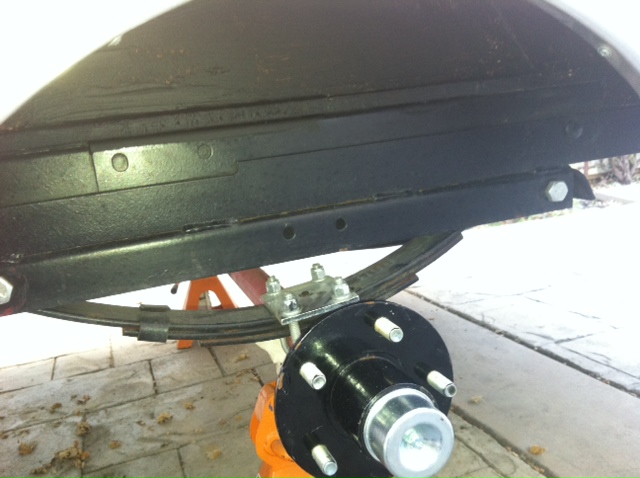

On second look, the bottom leaf on the HF 3 leaf set up looks more like a regular spring vs. a overload spring. It follows the contour of the middle spring vs. a overload spring like I have on my half ton Chevy Truck, whereby it is mostly flat and does not contact the other springs until heavily loaded. So I think I will just try removing the bottom spring. Thanks for the suggestion of using leaf spring liner. I have used this stuff on old leaf spring setups for 4WD vehicles and it quiets things done a lot, and facilitates the leafs moving against each other, thereby reducing friction. I think you can do the same thing with grease between the leafs, but thats kind of a mess. Here is a pic of the typical HF slipper spring.
