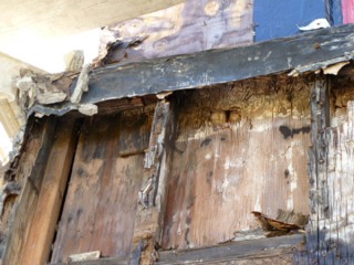

As a home inspector, I see "waterproof" exteriors installed without drain holes at bottom. They are completely destroyed.
Also look at commercially manufactured tube frame structures. They have drain holes drilled on underside to vent moisture.
In a "perfect" situation, water stays out, but leave a way for the occasional water to escape.
This is a three year old home.

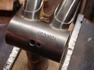

Under any bicycle, drain holes
