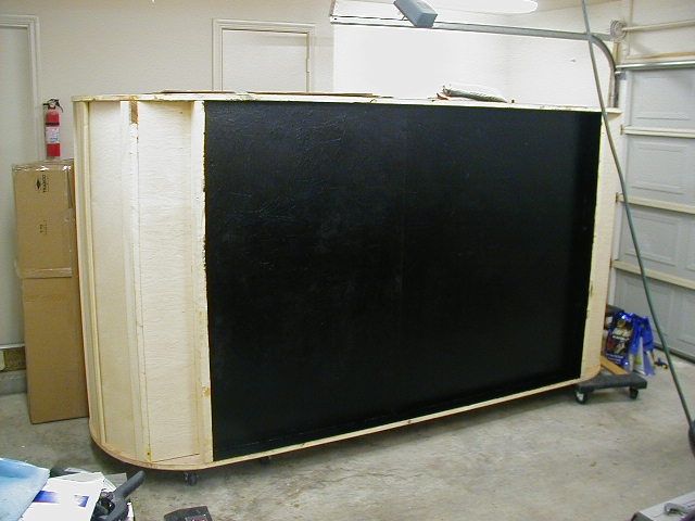

In this picture, the black part is the actual bottom of the trailer. The frame sits inside this area, I don't remember how long it is, but the overall outside length of the cabin is 10ft.

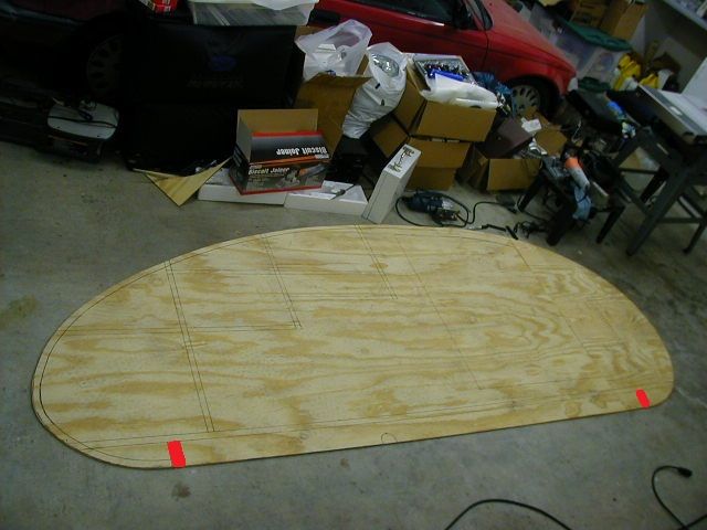

This is the template I made to figure out the layout of the cabinets. I edited the photo to mark where the crossmembers fall underneath.
