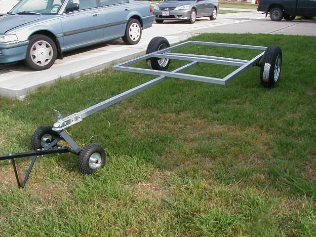

You don't need a "trailer" you just need a frame. The frame just provides the tongue, coupler, and axle a solid place to mount to. This is all you need, rent a saw and cut the pieces out and have a person weld it up for you. You'll get exactly what you need and it'll probably be similar in cost.

Ok what type of camping are you planning. I went with 2x2 1/4 inch framing with 2x3 1/4 inch for the tongue. i went with an aframe tonge and i now would of done just a straight tonge with angled supports.
Crunching numbers for a new frame looking like 1/8 inch box of 1-1/4 or 1-1/4 by 2 is the way i will go next time. bumper or rear crossmember was also 2x3.
you really just need a frame like stated above. it will help keep the weight down as long as you build the part rear of the axle strong.
Has far as plans go have the front and back members be the width you want then add teh side rails and about every 2 feet a crossmember for lateral support.
Have your tongue go back at least to the first crossmemeber
Also you can look at http://www.teardroptrailers.us/tbuild.pdf
http://www.richardflake.com/trailerchassisbuild.htm I like this one as well

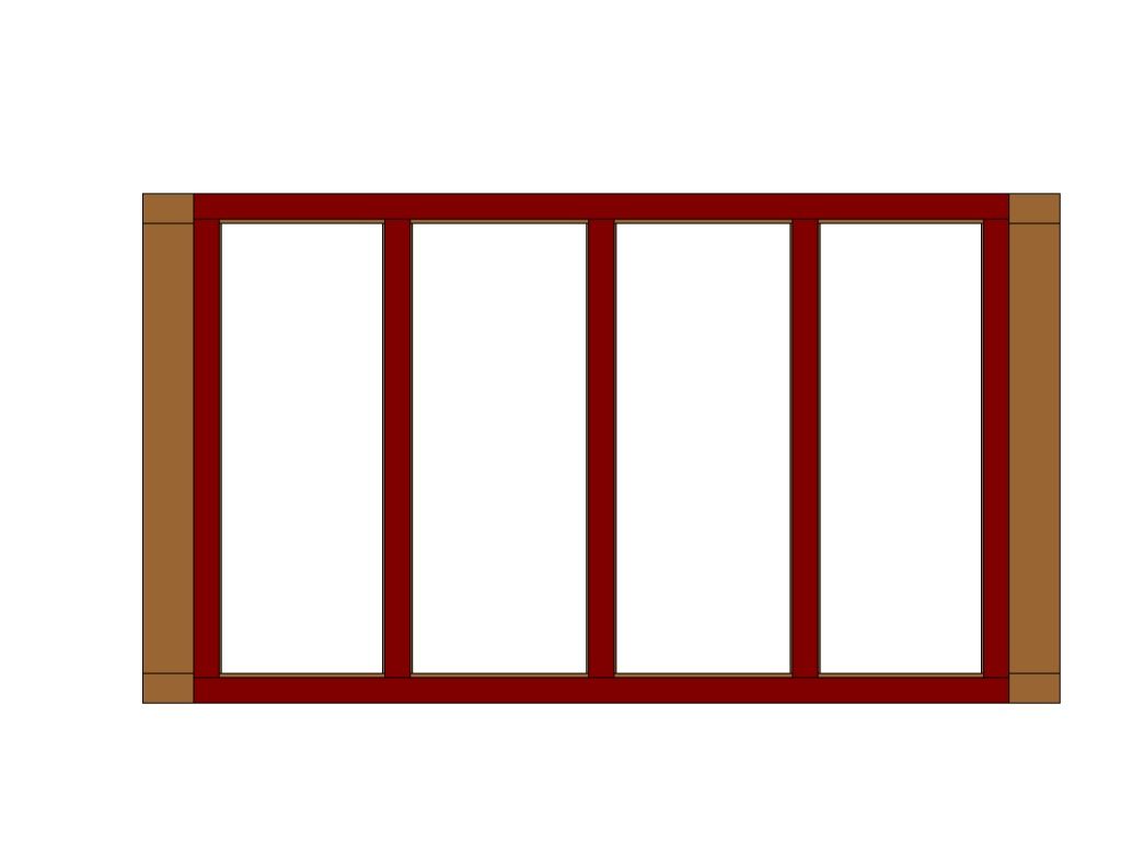

Because at the time of this posting I was looking at taking the 5x8 design and stretching it out to a 5x10 one giving me extra room in the Teardrop for cargo. The 8-foot design do not give the room needed to store a cooler unless I were willing to shrink down the mattress from a Queen to a Full (dropping from 80 inches to 75).
Something I can't do as I'm a pretty tall bloke.
I wanted to go with a 10-footer design which gives me serious room, gives room for nice storage in the crew compartment as well as the storage under the back hatch. And any of the 10-foot trailers have floors, heavy rails, life-gates...and cost more money than I want to spend on something I'm going to have to attack with a Recip-Saw.
I saw the NT trailer a week ago and I decided to scale back my plans a bit. I'm opting for the middle of the road and going with a 9-foot design sitting on an 8-foot trailer. I can safely extend out 6 inches in the front and in the back since there is no real load there and I can beef up the flooring frame with 10"-wide stock to maintain strength.
I'm using OpenOffice Draw and so I'm drawing the plans down to the quarter inch...I haven't put in the dimension markings yet but at full size, one inch equals one foot.
So thanks for the advice, the NT 5x8 is the way I'm going to go here. I do have one question about it though. The NT's tires are only rated for 45MPH. Any suggestions on tires to replace them with so it can handle highway speeds?
Bollocks. Looks like the image is being cut off. But imagine it's symmetrical.
