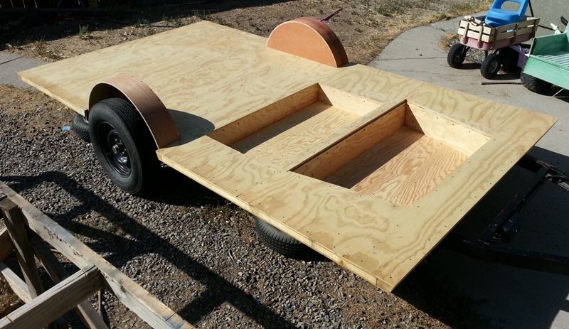

I am making mine out of 1/8" plywood laminated together to make 1/2". I will then use fiberglass and epoxy on the roadside, followed by a coating of rubber undecoating. Here is a picture of my floor with the plywood fender wells.
Dan
