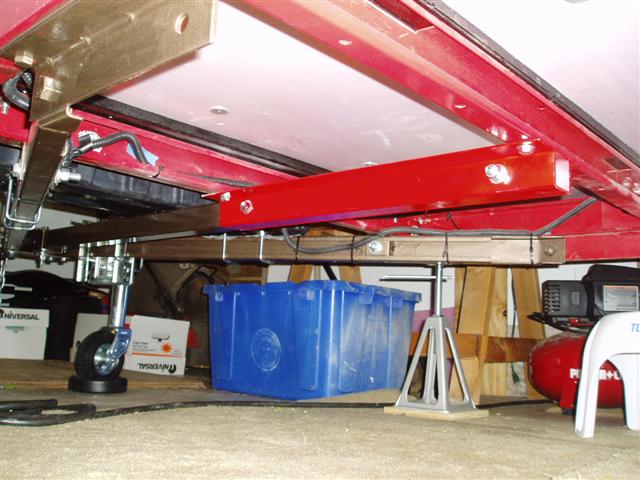

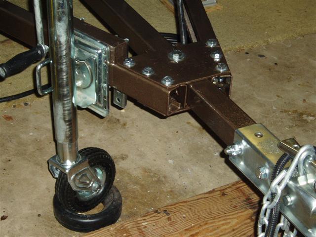

Here's another thought....... you might think about a different kind of tongue strengthening. Here's what I did and a number of others on the forum have done the same. I don't think I've heard of anyone who is sorry they've done this mod.
Good Luck,
Mike

Thanks for that suggestion, It's definitely my next option of this doesn't seem to hold. I'm a bit curious of the measurments on that steel tubing the coupler is bolted onto. My coupler is 2.5 inches wide but it seems more logical to use a 2 inch piece of tubing to slide through the front of the tongue.. Or perhaps I need to find a 2 inch coupler?

The tubing for the tongue extension is 2x2 and a new coupler was added to fit the 2x2 tubing. I got the new coupler (3500 lb capacity/2" ball) at Tractor Supply - about $20 as I recall. The extension goes back to the second cross member, although others on the forum have gone longer than mine.
