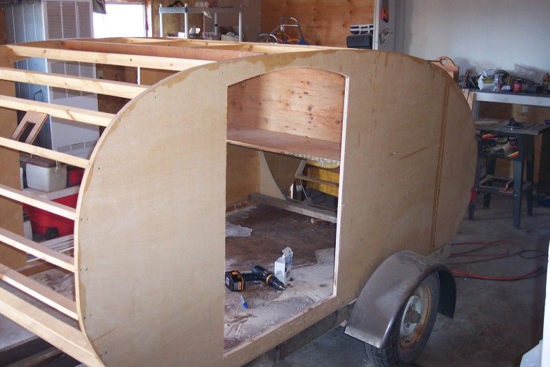

Here is the cabin on the frame:

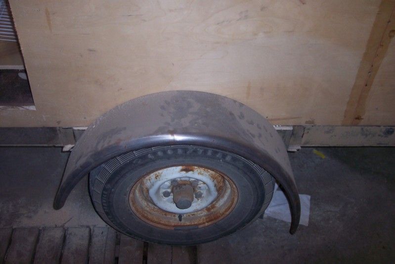

Axle is right where it should be:

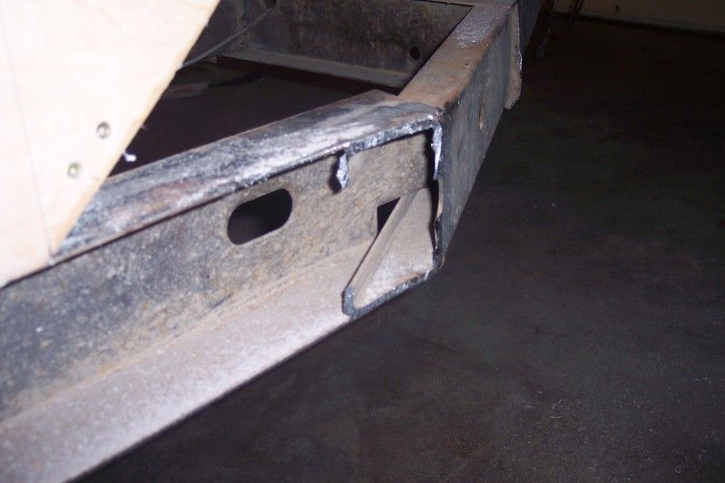

I had to cut the front off of the frame because the old camper was a couple feet farther forward (had to cut a few feet off the back too). I will box this in soon before it leaves the garage:

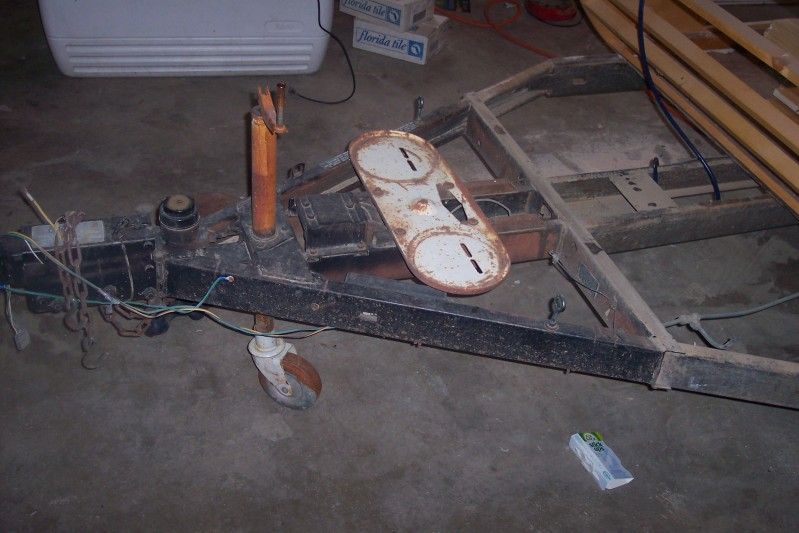

And finally, the tongue... The bottle mounts will be removed as will the winch to raise the old top. I still have to go through the surge brakes.

CARS wrote:But what will a longer tongue do to my tongue weight??
Going from 4' to 6'3" is no big problem for balance - it sounds like a big change but it's the difference in the lengths from the axle to the coupler that affect the hitch weight and that hasn't altered by anything like the same percentage. The longer tongue will make the trailer a bit more stable, so the slight loss in hitch weight won't reduce towing stability.
The other side to the question is: is the frame's tongue/A-frame strong enough? Going from 4' to 6'3" increases the load on the tongue by 50%, but from looking at your frame, I doubt it will have a problem as it was probably carrying twice the weight before as a pop-up.

Postby GuitarPhotog » Tue Oct 30, 2012 1:29 pm
Balance and weight distribution issues aside, a longer hitch to axle length (i.e., tongue length) makes backing the trailer easier.
My tongue is 7 feet long and backing the trailer is a cinch.
