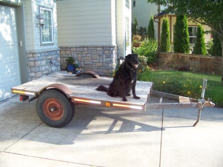

The trailer I am building on is "overbuilt" for my use, since it was built to haul ATVs. I'm almost worried it won't have enough weight on it. Given the axle that came on it, I'm limited to the wheels I can use, and therefore the size of tire. To lower the trailer a bit, I'm moving the axle to the inside of the leaf springs. Otherwise the galley will be too high to use. Once I get the wheels on and the platform on the trailer, I'll post a picture. Here's a picture with the wheels that came with it and the axle in its original position. The front of the floor begins about where the crossmember on the tongue is, and continues back for ten feet, putting 40% of the weight behind the wheels. The dog's name is Atticus, and he wants to be wherever I am.[img]

It doesn't have shocks, just leaf springs. I'll post a picture when I get it put together tomorrow. I don't know how I would even begin to retrofit shocks on it.
