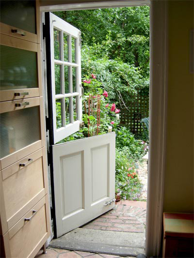

Postby Ron Dickey » Fri Feb 01, 2013 12:42 am
example
I am thinking about for a teardrop size?

While building custom minibarns I was asked to build one for a tiny horse. One request was for a dutch door. It was really far simpler than I had figured. I built my standard door of
t-111 and 1x4 halo edge and simply split it in the middle removing 2 1/4 inches. I laid a 2x6 flat and fastened it to the bottom section and a 1x2 under the top section as a rub board slightly tapering this board to make closing easier. I think it could be easily done even with a pre made door with a little ingenuity.

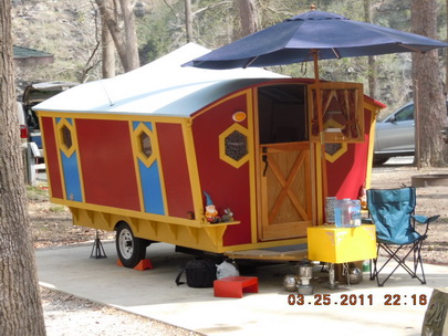

Steve Cox did when he built the Lil' Gypsy
“Fide Canem”
viewtopic.php?f=5&t=52816

Postby bobhenry » Fri Feb 01, 2013 12:24 pm
droid_ca wrote:Steve Cox did when he built the Lil' Gypsy
Grannie won't mind I stole this out of her album......
