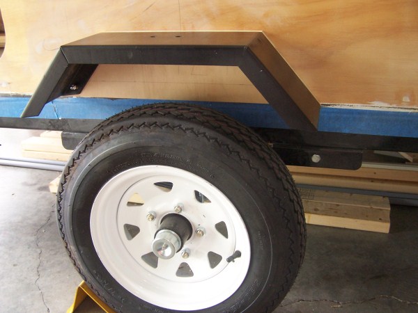

Bob, I don't have any direct experience with changing out the wheels on an NT trailer, but I have done a lot of research which led me to stick with my 12 inchers. The problem with changing to the larger tires is that you have less than 2" of clearance between the 12" tires and the frame. Larger tires get taller and wider in a hurry when you go above 12" so you have to be very careful to find a narrow profile tire if you try to use the stock axle. However, you can find longer axle beams generally for under $100 at NT or HF that will take the same hubs that come on a stock trailer. When you start using adapters or car wheels to gain the clearance you are introducing an offset situation that causes unbalanced loading on your wheel bearings and the chance of premature failure. The stock trailer wheel has zero offset which means that the center of the tire is at the center of the wheel and the face of the hub causing an equal loading on the inner and outer bearings. I was looking at moving up to 13" but I decided to stay with my 12 inchers because they didn't look that bad and the extra height would have caused a major re-work of my fenders. Specially fabricated frames can get expensive depending on the shop that you use. I would run the numbers both ways before making a decision. Also, consider the re-sale value of the stock axle, wheels, and tires that you wouldn't be using if you modify the stock NT trailer.

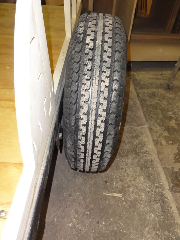

I used 1" wheel spacers to get 15" tires on the "Slowmobile" . But you need to shop for wheels with the right backspacing. Mine had zero backspacing and the 1" made them fit.
Here is how it worked out without the spacers. I still needed to add about an inch of wood. So once the spacres went on I ended up with the same clearance as the picture.

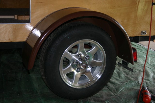

I put some 13" tires and rims on mine and I still had 1" between the tires and frame. They don't look too bad.
Take a look at my gallery for more images.

Thanks for the reply's folks ! Tim , you are right , those 13" tires with the round fenders do look good . Larry , I know the 12" tires & wheels will get the job done but I just can't get around some things about them . One concern is that with that 45 mile per hour warning on them ( even though it may just be for the purpose of covering the manufacturer ) , I'm concerned that my insurance company might not cover me if there was an accident at over 45 miles per hour . The idea of having a 13", 14" or 15" passenger car tire with less air pressure & what might be a smoother ride ( especially over rough ground or pot-holes )is appealing to me as well, along with the fact that they just look better to me . I may be way offline but this makes sense to me . Woodbutcher , where did you get your 1" spacers ? Tim , did your wheels bolt right on to your NT 5x8 trailer without any mods ? What wheels did you use ?

My 13" wheels bolted right up to my trailer without spacers or mods. I picked the wheels up on ebay. Honestly, I'm not sure what brand they are. I just made sure I purchased the right bolt pattern.
