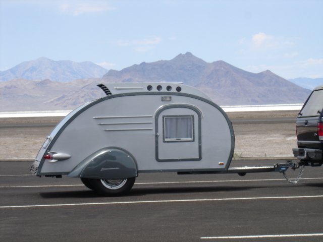

I've built a 4'6" x 10 foot with a steel frame 4" drop axle 3500# on springs that came in at 960# 6 years and it's still being used regularly, (I camp with the new owners) , less food and full cooler. I also don't load up with a ton of stuff that probably won't be used. Full decking in metal isn't necessary. Licensing a tear in Ca. isn't all that big of a hassle either, not like PA....Just take in all the receipts with a copy to give them at DMV. No brakes necessary on a trailer of that weight.
Steel is less expensive and less hassle if someone else is going to design it. Aluminum isn't always the light weight answer. Watch for someone that is concerned about building something just to cover their butt. They always go heavy on the frame. The trailer in the following pic has been across the country and has been towed up to 90 mph, solid ply walls, insulated ceiling. Just my opinion, others may differ. Doug
