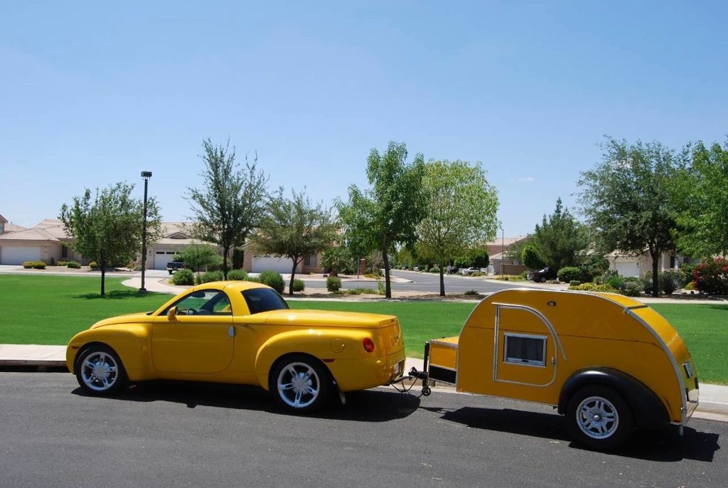

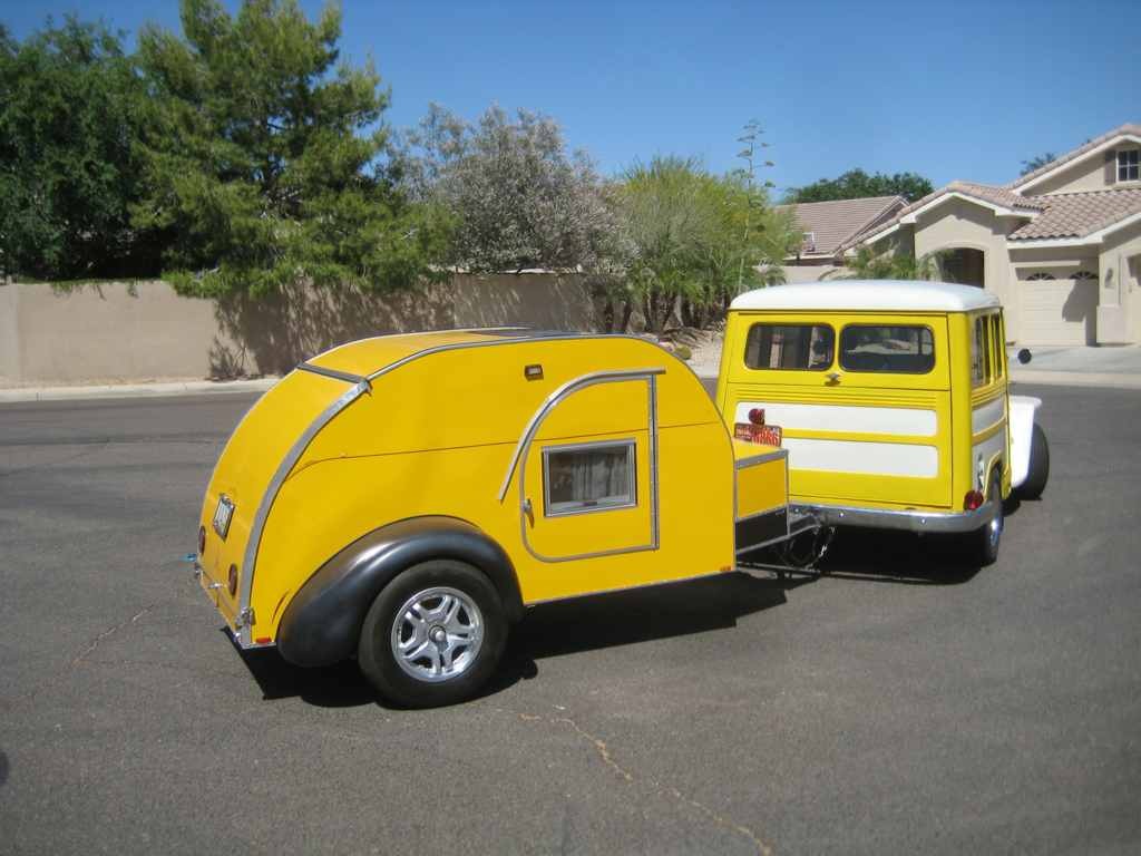

Postby ssrjim » Tue Jun 18, 2013 6:51 pm
Most important thing is how it looks pulling the trailer
And color is important too...

As always you guys are a wealth of information and food for thought. Love the yellow rigs and trailers! And it's true, color is important. I thought I was a veteran with Subaru #3.

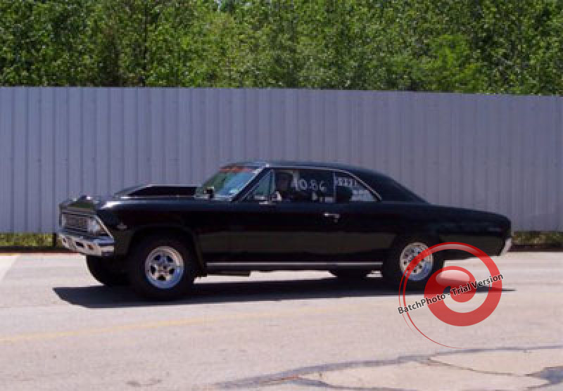

Postby working on it » Tue Jun 18, 2013 9:30 pm
ssrjim wrote:Most important thing is how it looks pulling the trailer
Agreed, very important, but my preferred tow vehicle needs a tanker truck to follow it.
