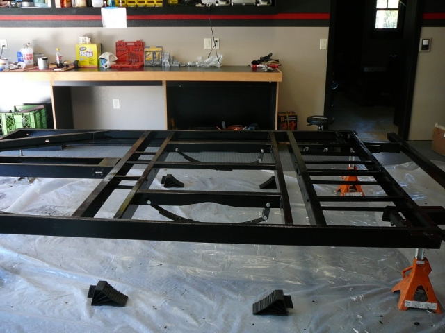

Here is a starcraft frame it might not be yours but it is a frame.....
The beauty of these is you can sleep side to side and have more cabin room. I would loose the bumper to shorten the trailer a bit but that's just my take.

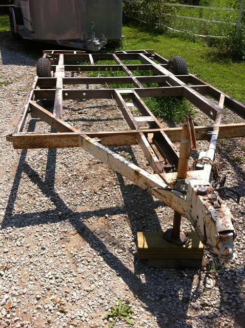

Here's a photo of the chassis from the pop-up camper.

Postby KCStudly » Sat Aug 24, 2013 6:18 pm
Yours is different from Bob's pic in that your main frame rails travel down along the inside of the wheel wells, whereas his pic shows a frame where the main rails travel outside of the wheels.
Yours would be much, much easier to narrow if you should choose to do so. All it would take is making sure that those angled tongue members tie into the main rails really well, and cut the rest of the outboard stuff off.
However, I would consider another, third, or perhaps forth option.
How about building the cabin between the wheel wells and having a deck with storage boxes round the outside perimeter (3rd option), or building the cabin out partially over the wheels with just half width fenders (4th option).
