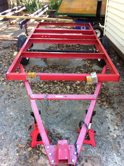

The photo above is my trailer that I purchased from a 15y.o. boy who put it together using all the wrong hardware and tools. Anyway, it's mine now and I intend to use it. :roll: It is a 4'x8' HF folding trailer that has been welded so it doesn't fold. I put 13" wheels on it.
I intend to build a semi-standy that is 5'x8'. The axle is below the springs.

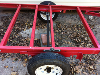

Please refer to the amidship photo. The axle is currently situated exactly 1/2 the distance between forward and aft of the trailer. The back of the wheel lies about 37.5" from the rear.
FIRST QUESTION: Should the axle be moved back?
I might mention that my build is not exactly a tear drop shape, but rather a modified shed roof style with the tongue end (forward) being about 4.5' tall and the after end (back where the door will be) will be about 5.5' tall. All built ins will be as close to center of gravity as possible, with perhaps a little more weight on the rear end.
SECOND QUESTION:
I have see many examples of the trailer cross bars being moved around or eliminated entirely. The most common I have seen is removing the cross bar that is directly or almost directly over the axle. Is there a reason for that? Should I remove the cross bar that is pictured just to the right of the axle in the photo?

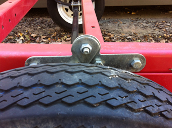

Please see the photo of the close of the wheel and the bracket above the wheel. What is that bracket? Do I need that? Can I remove it without the trailer coming apart at the seams (as I am about to do)?

Isn't that bracket for when it folds? The folding ability you said has been welded so it won't fold so that bracket I would think can be removed. I would make a side plate to replace it...just maybe a few inches wide. But not to protrude above the frame?

Joy,
#1 Almost always, yes.
Balance is the key, having the right amount of weight in front of the axle, and behind is important.
Your design and weight distribution plan will determine the best place for the axle. In almost all builds/designs, square in the middle creates a trailer that is unstable and prone to sway/instability.
#2 I've never owned a similar trailer so have no experience with the crossmember, but it appears that because it is (was) a folding trailer, there is a support on either side of the hinge. Once the ability to fold is removed, there simply is no need for the extra weight. That said, it isn't hurting anything unless you are looking for places to remove weight.
#3 It is the hinge that allows the trailer to fold.
Ask the person who welded the trailer, hopefully not the one who put it together...
I am unable to enlarge the picture to get a close up view, but it does not appear that anything has been done at the joint where it folds to prevent folding, or to reinforce that area.
In other words, that hinge is holding the two halves together, if you remove it, you must somehow fasten the two halves together.

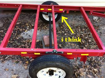

Weld the axle trolly to the frame as seen with the yellow marked edits I made to your pic this will take the strain off of the hinge itsself and greatly stiffen the frame.
My 75.00 e bay find hf trailer was crushed under a bolder being loaded on the trailer. The frame was trashed so I used the axle dolly and a some dock handrailing as the new frame. Here is the weld in the same place I am suggesting.....

I blew up picture to 1024 X 768 and I personally do not see where its welded, at least not welded where I would expect it to be....
Axle to brace position2.jpg (136.91 KiB) Viewed 1125 times
My concept as where it should be welded should be pretty much like "edits" on picture BobHenery did... Also on insides where back of frame sits on rails where the springs are mounted...

Many thanks to everyone who replied to my questions! I guess it's time to take the trailer to the metal shop and have some welding and modifications made, according to the good information offered here. I do plan to remove the centermost support nearest to the axle for weight-saving. Later today/tonight I will scan and post my plan for the floor frame (since I am building an over the wheels trailer) for review and input.

Yeah!.... Blown up pic sorta-somewhat shows "something "(maybe trick of light) but if there is a bead on inside bottom, its not sufficient to give real strength...
