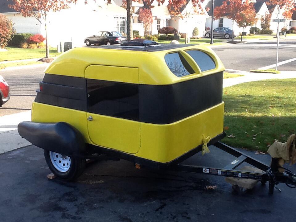

We want to add a tongue box to the front of the tear drop. The widest point which is closest to the teardrop is 41 inches. They don't make 41 inch wide tongue boxes. I don't understand why because the trailer before the teardrop was built was a regular 5X8 trailer so I would imagine that they would make tongue boxes to fit. Has anyone else run into this problem? Or does anyone know a good company that sells tongue boxes of this size? We could go with a smaller box, but that would leave a big space between the teardrop and the box. We plan on putting the battery in the box and don't really want the space there. HELP!

Hi City lights. Thank you for responding. I like your tear drop. Looks great. I'm worried about too much front load if I go with a big box like you have, plus I don't want to take away from the "cuteness" of our little bumble bee pod.

hwbout wrote:Hi City lights. Thank you for responding. I like your tear drop. Looks great. I'm worried about too much front load if I go with a big box like you have, plus I don't want to take away from the "cuteness" of our little bumble bee pod.

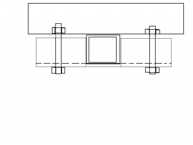

Postby bobhenry » Wed Nov 13, 2013 7:30 am
It's really pretty amazing what you can put in a simple old cooler.
Alas I had to drill 2 holes in the bottom because of the stealth way I mounted it but it will still serve it's original function when asked to. However , I use it for the jack and hardware type goodies that might snag or grease stain the bedding inside.
and it's cute ! :D
I placed a flat steel plate in the bottom of the cooler and then some closed cell foam two bolts were inserted thru the plate and thru a 1 1/2 x 1 1/2 angle into which a 2" notch had been cut. as the bolts are tightened the vertical edges pinch into the tongue tube and grab hold. It has been on the road several hundred miles and has never needed attention.
It can be removed at any time with little notice except a couple of spots on the tongue where the paint may need touched up.
