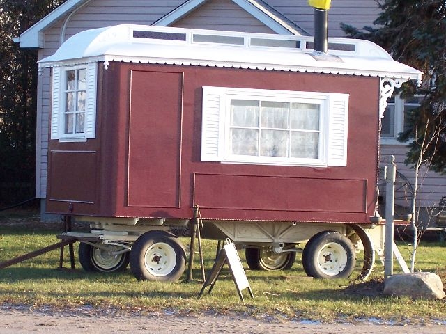

Postby Micro469 » Tue Feb 04, 2014 12:17 am
Like this??
