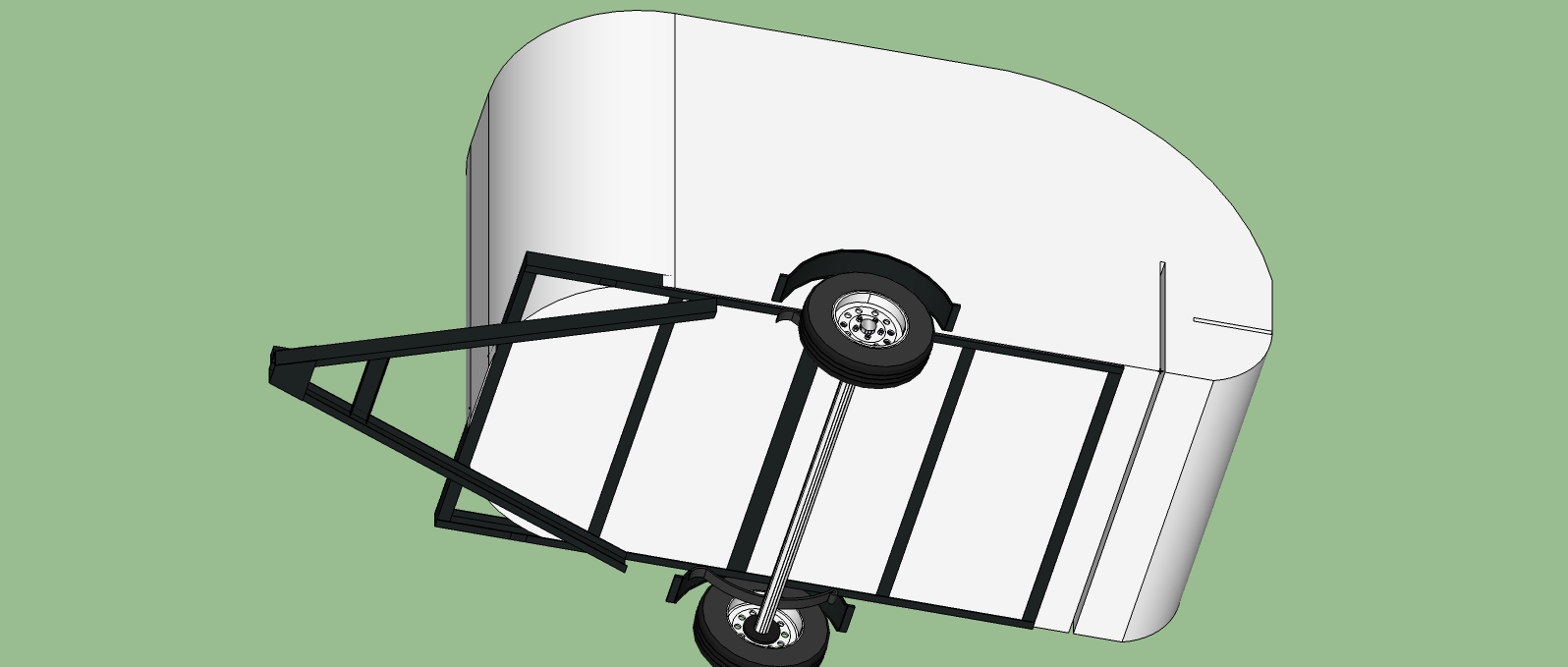

Postby Gunguy05 » Thu Dec 19, 2013 11:10 pm
Humm... Just a very rough sketch of things, but how to deal with the squared off frame?
I'm thinking have it cut/welded to the angle so that it is just under the cab.
I know there is no floor yet. Just trying to get the shape figured out.

Re: 5x10 Bowfront, Raindrop on 5x8 frame?? or 5x10
Postby bobhenry » Fri Dec 20, 2013 7:18 am
You really need to cantilever off of the nose of the trailer not the rear. As drawn you have a swaying nightmare.
Total body length as you have designed is 120" 60 percent of this need to be forward of the axle (72")
and 40 percent to the rear (48") Actually 65 / 35 weight distribution is even better if tongue weight is no problem to the towing vehicle. Rather than mess with the axle location simply extend the tongue enough to allow you to encroach the 2 foot forward. Inserting a square tube in the center of the a frame tongue simply adds extra strength. Moving the body forward also negates the need to alter the square corner at the front of the frame. :thumbsup:
Postby Gunguy05 » Fri Dec 20, 2013 7:24 am
bobhenry wrote:You really need to cantilever off of the nose of the trailer not the rear. As drawn you have a swaying nightmare.
I wasn't sure about extending the tongue. I thought that moving the axle would be easier, but with the squared off frame, and the balance issue, if that is better then I will look into that.
I hadn't moved the axle in the drawing, but was going to if needed. But like I said if the above fixes both...
Postby Cary Winch » Fri Dec 20, 2013 10:40 am
Brian,
If you trimmed off the square corners of the frame your frame would look a lot like our Raindrop frame then. That is how we do it, the side rails of the frame simply turn at the angle. We do add reinforcements under this however to "girder" it up for the needed tongue strength on a Raindrop.
Indeed your axle need to move back significantly. For a trailer not to sway you need at least 10% of the trailer's total weight on the tongue. We target 12.5% on our 8' models to allow the customer loading flexibility and to account for a two bike bike rack on the hitch option in back. On a Raindrop however we actually put more weight on,close to 15%. Since the heaviest area of your trailer is the galley a good share of the trailer weight is behind the axle. On a shorter 8' model the axle ends up under some of the galley and load variances in the galley (cooler, pots, pans, food, etc) have a smaller effect on the tongue weight. But, with a 10' teardrop the axle ends up further forward a bit and this shifts the axle a bit forward of the heaviest load items in the galley. This means loads in the galley have a more pronounced effect on tongue weight due to increased moment arm. To account for this we actually leave the axle rearward a tad making the tongue heavier when empty. But, as you load the trailer in the galley the trailer's tongue will get a lighter. A really fully loaded Raindrop will have a tongue weight of about 10%. There is a much more interesting challenge to figuring out axle location on a 10' teardrop. 8" teardrops are relatively simple.
One idea looking at your drawing. Maybe you could make your axle movable? Drill a series of mounting holes at 1" increments or something. Try loading (full cooler, water in tank, pots, pans and other weight) it up and moving the axle around until you get a happy tongue weight. Then mount the fenders, once you are good on tongue weight.
Postby Gunguy05 » Fri Dec 20, 2013 11:31 am
Cary Winch wrote:Brian,
