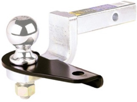

A longer tongue makes for easier reversing, IMO. Just make it strong enough. You can make / install a dropped tongue extension that will help with hitch height alignment. Level or a slight down at the front is what you want for stability, as has been mentioned. The extension tongue should extend under at least the front and the next crossmember back as well as under the front of the A-frame.
