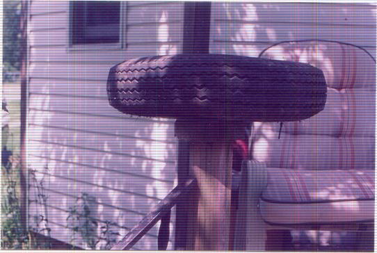

Here is a DURO you can have.......
Yes it's that crooked. We call it ply seperation!
Called the plant in Alabama about warranty claim procedure and in short they told me "tough luck"
All tires I have purchased since then have been Carlisle's and I am quite happy with them no problems to date.
