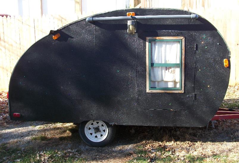

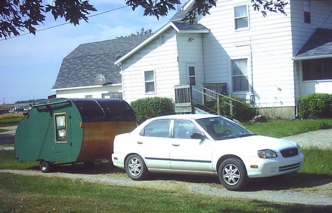

Chubby had a luan face and multiple coats of marine spar varnish, later house paint , then another coat of house paint laced with sparkles to hide some of the blistering and delamination. He was out side in the rain and snow 24-7 for 5 heart breaking years. I will never have a woody again if submitted to outside storage only.
The pictures cover the 6 years of Chubbys life. He is finally inside and safe however I thing his refacing will be with dove grey or a mocah brown FRP panel this summer for a maintainance free finish.
