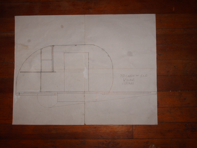

Postby ctstaas » Tue Aug 26, 2014 10:16 am
5x10 TD 004.JPG (63.44 KiB) Viewed 2296 times

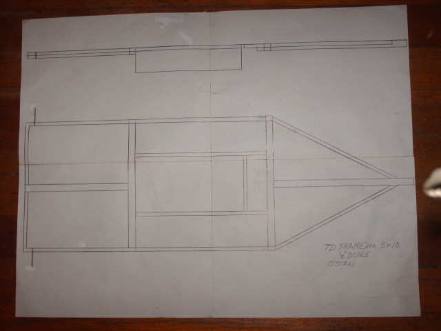

Hi everyone and thanks for your input. I wanted the drop floor for times when you need to be inside for longer periods of time and want to be comfortable. I've been planning and here's what I've come up with for my drop floor idea. I can get away with about 12" of depth from the top of the floor. I drew a line from the end of the tongue to the bottom of the tire and did not let my projection be below this line. I wanted foot space for four, so I went with a 2' x 4' of floor space. This will make fabrication easier also. The 16 GA box will measure 2' x 4' x 9 3/4" and weld to the bottom of the frame, making both stronger. I wanted to have a bench of around 16" to sit on. I will only be able to use three sides to sit on because the fourth is below the shelf and cabinet. There are kits available to make the slug into a table cheaper then I could build.
The cabin shelf/ cabinet and galley shelf are the same design as my 4'x 8' and work well so no redesign needed. A blank canvas in the galley. I plan to insulate the roof and finish the ceiling and run power in the roof for lights and a fan, both 110 and 12 V. The walls won't be insulated.
The frame will be made of 1 1/2 x 0.65" and 3 x .120" square tubing and a 16 GA sheet metal drop box. Strong enough but still light. I figured it would weight under 250#. Steel is costing around $1.00 per pound, so go figure. I want to use torsion axles with brakes. I'll have a receiver in the back and a tongue box for the propane, batteries and spare. The light brackets will be 1/4" x 3" plate welded to the frame.
Here are my drawings. Enjoy, Chris

Postby ctstaas » Tue Aug 26, 2014 10:20 am
5x10 TD 003.JPG (63.09 KiB) Viewed 2296 times
Hi There, I couldn't figure out to post two pics at the same time so jere is the other. Enjoy, Chris

Postby 48Rob » Fri Aug 29, 2014 6:46 am
Chris,
When I determined the maximum floor drop on my trailer project I drew a similar line.
However, after thinking about it for awhile, I realized that the plan counted on having fully inflated tires.
If one of them ever went flat, and the tongue touched the ground the drop floor would hit the ground and be pushed up.
The soulution was of course to adjust the line to the bottom of the wheel rim.
For added measure I welded a couple 1/4" plates to the frame that would act as wear plates if it ever contacted the pavement.
Rob
