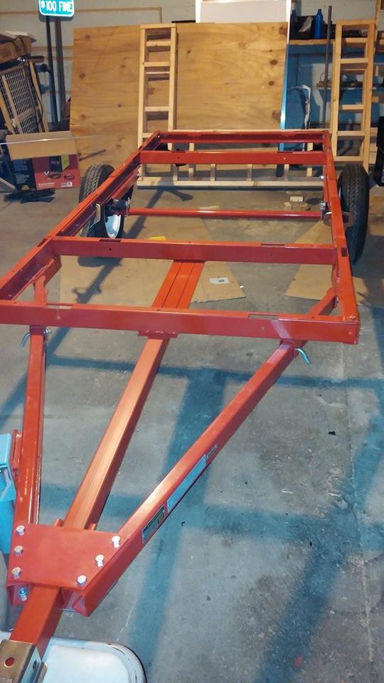

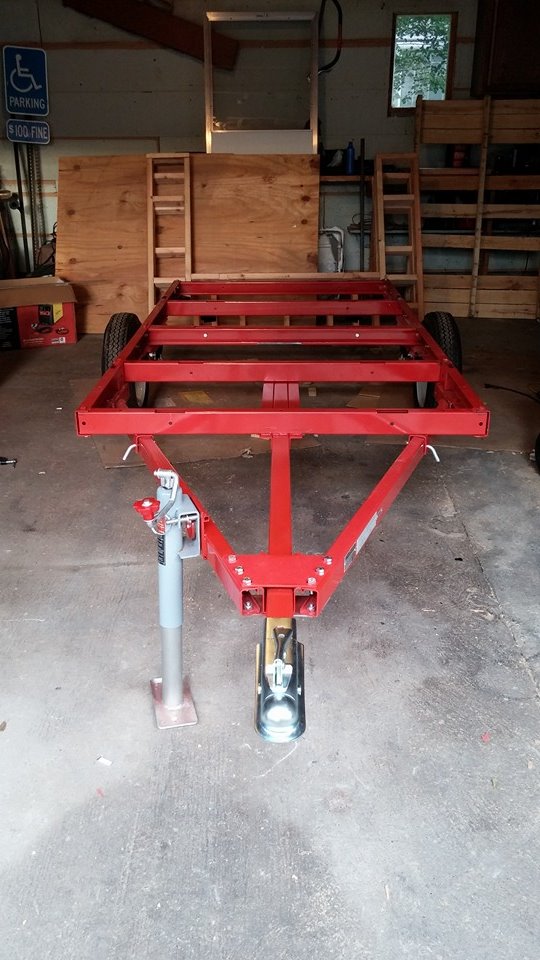

My question is weather or not I will have a strength problem if I relocate my tounge to the new 2x2 tube I added to the frame. Should i cut off the excess and put it back where it was?
This is before I lengthened it.

Not sure exactly what the question is you're asking, & you do not say what thickness of 2x2" steel tubing you used. Are you talking about relocating your coupler? My original tongue modification used a 2x2" tube of approx 10gauge (more than 1/8" thickness but less than 3/16"). The tube extends approx 16" forward of the original coupler mounting plate which I inverted. I mounted a coupler which looks very similar to yours, on the 2x2" tube so the 'nose' of the coupler is approx 21" forward of the original mounting plate, 10 1/4" between rear of coupler & mounting plate. See pix in this thread - http://tnttt.com/viewtopic.php?f=35&t=6 ... 1#p1085971 - My TD weighs 980# on the wheels with tongue weight of 160-175#. I've towed it more'n 25K miles since the build over most every kind of road/terrain. The tongue mod & coupler still look exactly the same as when built, no 'deformation', twist, or other problem.
Harvey -

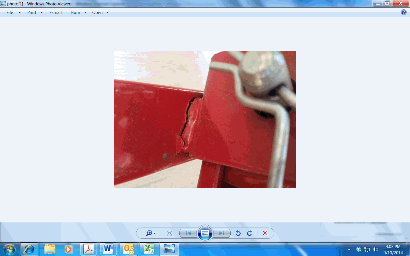

Postby professor.smith » Wed Sep 10, 2014 4:11 pm
strengthing toung of HF trailer is a good idea. all the welds where the pins hold the front of the tounge broke after about 8000 miles.
tounge of HF trailer after 8000 miles
weld breal HF trailer.gif (121.72 KiB) Viewed 827 times
