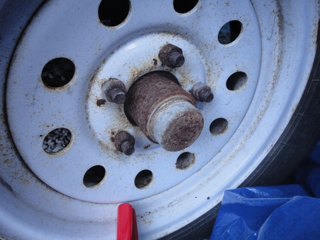

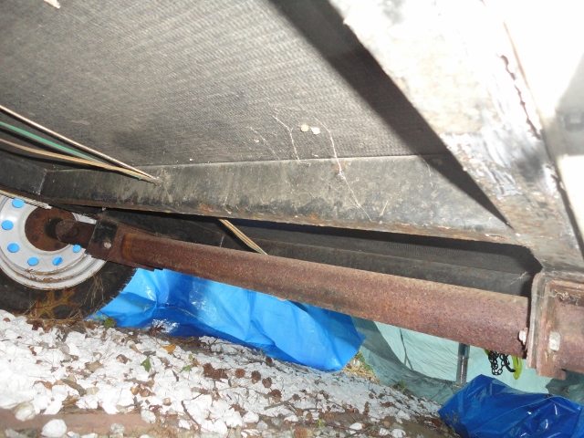

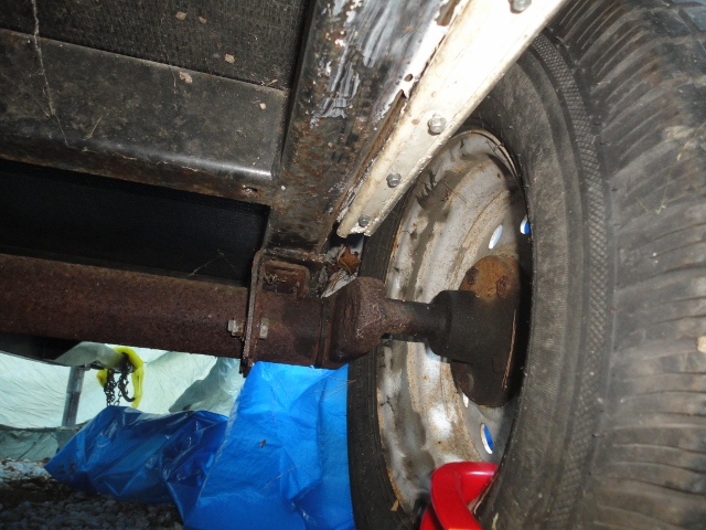

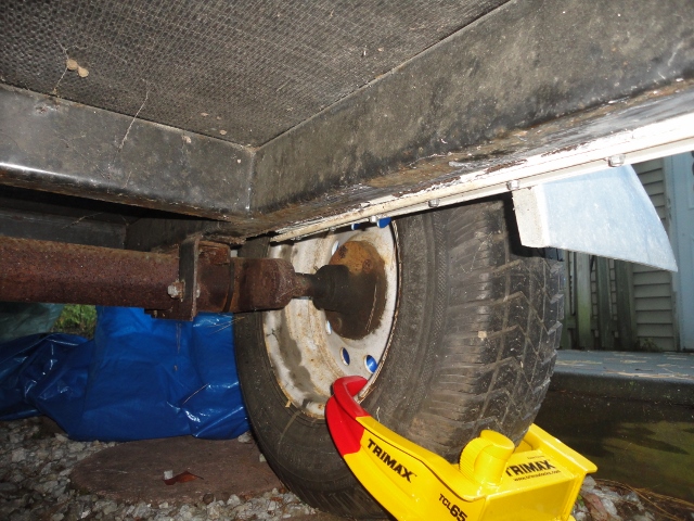

Postby yung7928 » Wed Oct 08, 2014 10:27 am
yung7928
Posts: 12
Images: 15
Joined: Wed Oct 01, 2014 3:25 pm
Re: 2005 Little guy Rascal Axles & bearing kit?
Postby Dale M. » Wed Oct 08, 2014 11:30 am
Does not appear if anything serious is going on, appears to be surface rust and scale.... For wheels and hubs remove them, clean them and primer with good quality rust inhibitor paint...
For axle, there is two choices, remove it and put it across some supports and use cup wheel and angle grinder to clean up... Second choice is attempt to do it still attached the trailer.....NOT VERY GOOD IDEA- NOT RECOMMENDED...
Might consider removing axles and wheels and hubs, and take them to local "media blaster" (sand blaster) and let them do clean up, and all you need to do is the rust inhibitor painting ( or maybe power coat)... Do this once and do it right and you probably not have to worry about it again ...Ever....
Sure removing and replacing is a pain in the toush, but to be worry free its worth it... IT appears you have torsion axle and and only 4 bolts to drop it out and have work done or you do it up on saw horses when you can access everything easily and safely (all depends on your skills and abilities)...

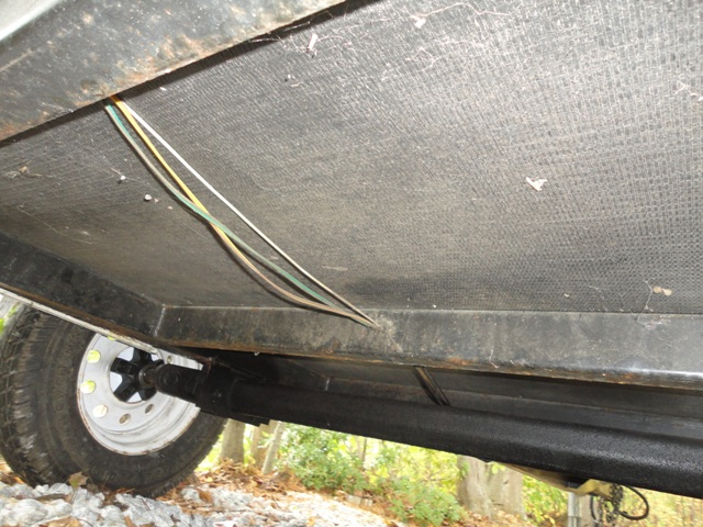

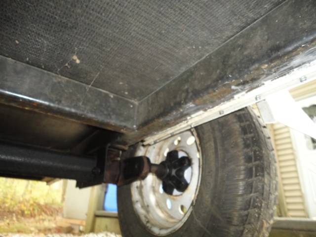

Postby yung7928 » Tue Oct 21, 2014 3:46 pm
Hi All, updated after repair from local Trailer Shop. He replaced the Hub and repainted the axles, even throw in the cap too.
It costs me $75 plus taxes. Please see the pic below & give me some input. Thanks! :D
gallery/image.php?album_id=3712&image_id=125543
gallery/image.php?album_id=3712&image_id=125542
