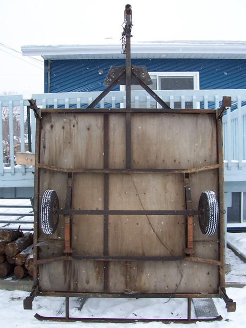

Postby angib » Wed Oct 15, 2014 10:55 am
Yes, the problem I see with pop-up frames is if you want to narrow them to the normal width of a teardrop, you have to virtually rebuild them from scratch.
Here is an example, where the main strength running from front to back is right on the outside edges, so if those rails are cut off to narrow the trailer, there is nothing left connecting the front and the back. We call this A Bad Idea.
