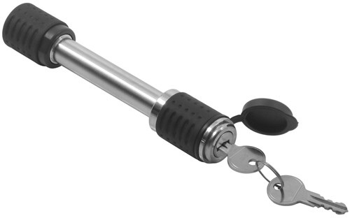

I have seemed to have lost my keys to my hitch receiver lock. The lock is similar to this:
All I know what to do is to either try and cut it which i do not is possible,
grind the opposite end from the lock, which again I think will not work,
try to beat the key end to death with a heavy hammer and even though I have done that with heavy hammers on typical padlocks before, I do not think it will work on this setup,
and finally, talk to a friend with a cutting torch to see if torch cutting is doable.
Does anyone habe sucessful experience with this problem?

Postby dales133 » Sat Dec 20, 2014 10:10 pm
Drilling the barrel works on most locks but you'll need to step up drill sizes.
How do I know? I used to have to break into about 25 houses a week for evictions or lock outs.
It probably will cut with a grinder though

I have on occasion used a 4.5" angle grinder with a cut off wheel to remove a lock, an alternative is a bolt cutter.

Shadow Catcher wrote:I have on occasion used a 4.5" angle grinder with a cut off wheel to remove a lock, an alternative is a bolt cutter.
Never seen a piece of steel resist the grinder (for long).... If you don't have one, stop by a fabrication shop, should take about 30 seconds to remove it...
