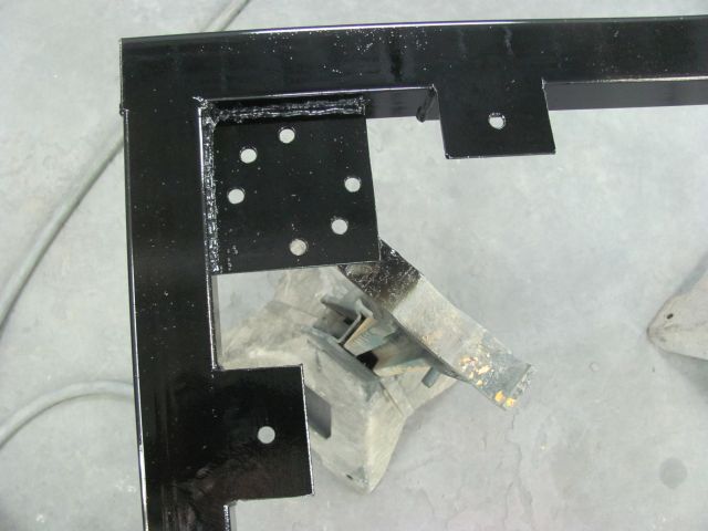

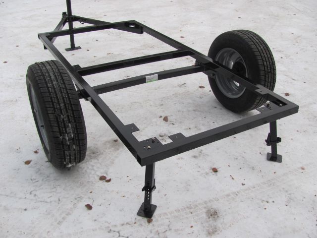

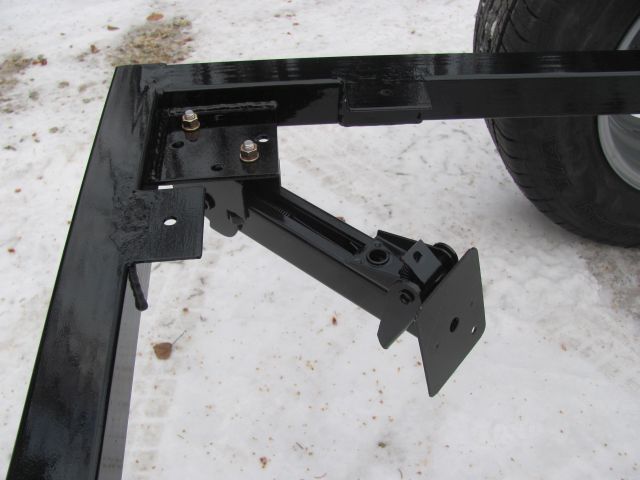

Postby ratrod71 » Sat Jan 24, 2015 4:47 pm
I welded steel plates into the rear corners. And I drilled three sets of holes to give me options on which angle I wanted to mount them in case there was any clearance problems. Bryan
