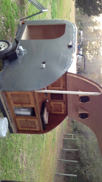

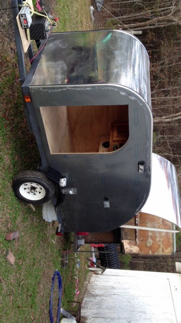

I too painted mine with auto primer and follow up with grey enamel paint
