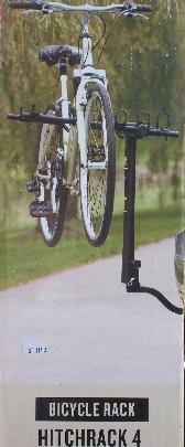

Get the 2", all the other stuff you want to mount on the hitch is better for 2". Stuff like bike racks, cargo trays, ski racks, etc. They all put torque on the hitch, 2" is stronger.

Postby bobhenry » Thu May 07, 2015 6:35 am
rowerwet wrote:Get the 2", all the other stuff you want to mount on the hitch is better for 2". Stuff like bike racks, cargo trays, ski racks, etc. They all put torque on the hitch, 2" is stronger.
Some of the accessory items you listed are actually designed to fit in an 1 1/4 receiver they come with a super hard plastic sleeve to ADAPT to the 2" receiver.

Postby rowerwet » Fri May 08, 2015 4:48 am
Having a car with 1.25 and a van with 2" I know the better stuff comes in 2", at least around here. The 1.25" is usually more expensive and not as capable. None of my 2" has an adapter.
