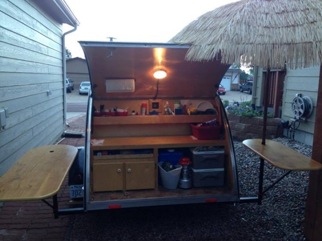

Here is one of the many good ideas....
Troy's frame mounted removable tables.......
