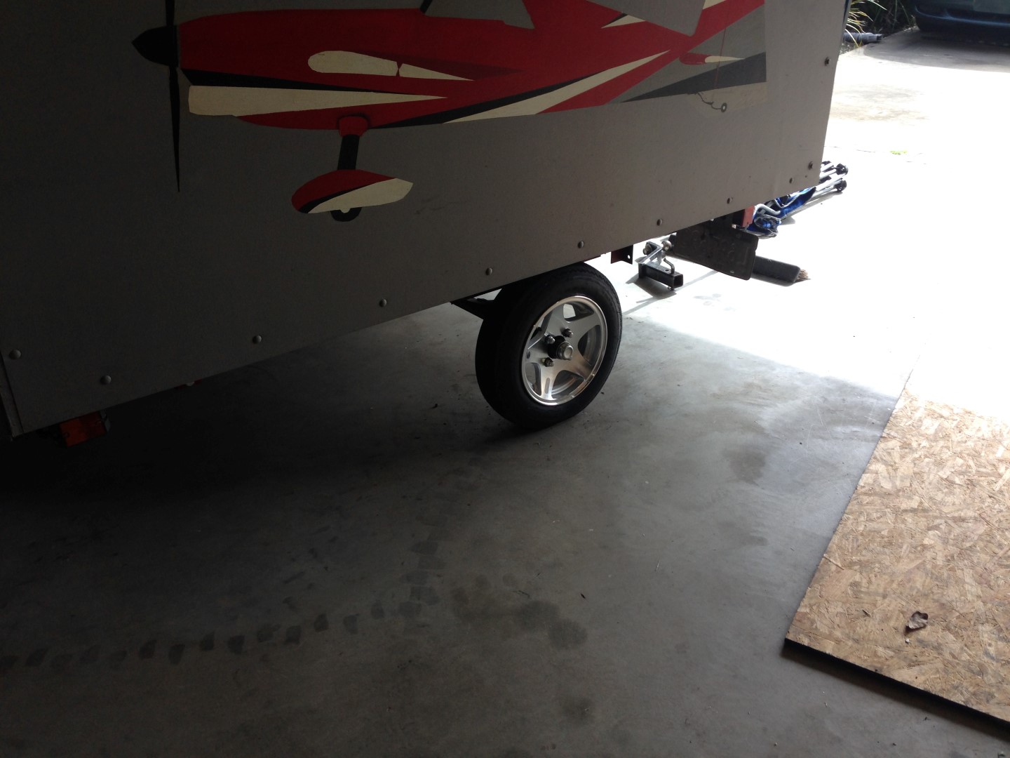

Postby robj » Mon Jul 06, 2015 4:26 pm
Thought I'd share how I got more width. I lowered the axle and ran the deck over the wheels, no fenders. My total width on the plane trailer is about 56". This trailer is about 3 years old and has been towed around 8-10k miles.
I'm about to replace the axle and hub with a more solid axle and cast hubs. sticking with the 4x4 wheels.

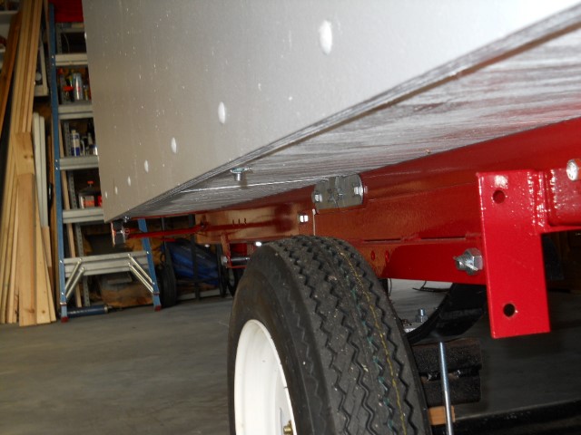

Postby robj » Tue Jul 07, 2015 7:58 am
I think I have about 2-2.5" only. Not much but I can get a measurement for you. I also removed the smallest 3th leaf to try and soften up the ride. Tires are 12x4.80, stockers. All the weight is in the box. The giant scale planes(9' wingspan) only weigh about 27 pounds, it holds 2 and a gas can. Not much weight. But I have hauled furniture before and never had a problem. I think the spacer is 3" and the spring another 1/4".
here is a build picture but notice I don't have that wood spacer in there anymore.

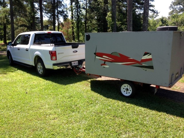

It's mostly just for planes. I have slept in it before. Toss in some foam and a sleeping bag and a fan! I'm down on the gulf coast unless I drive to another fly in. Heading to Knoxville next week.
