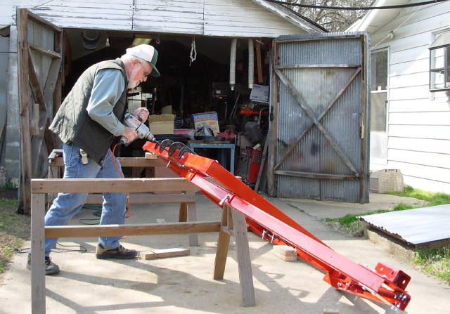

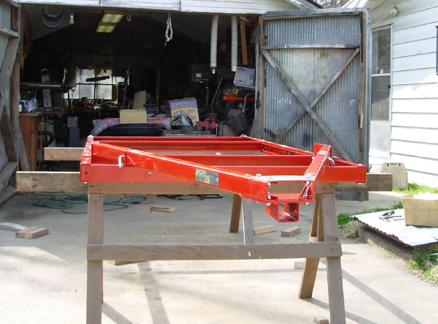

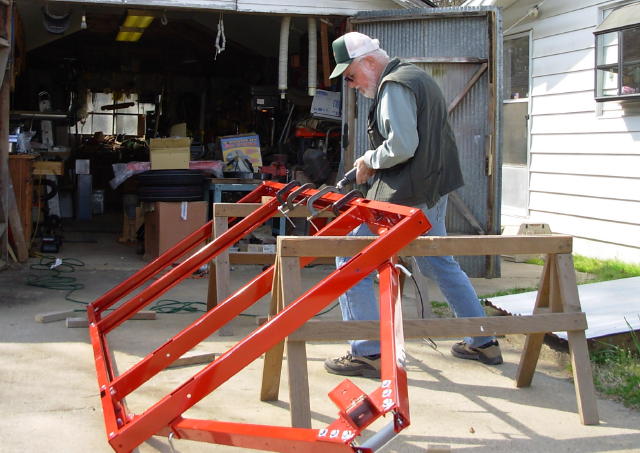

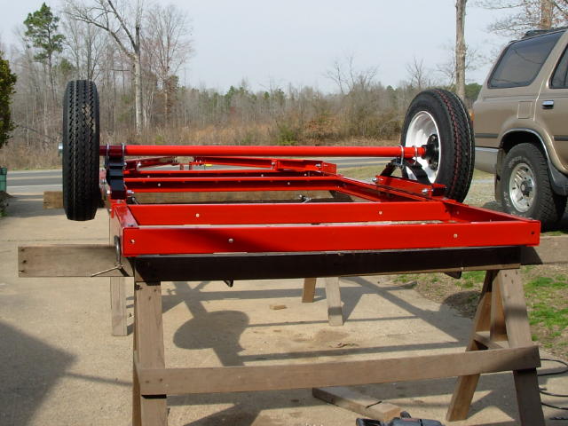

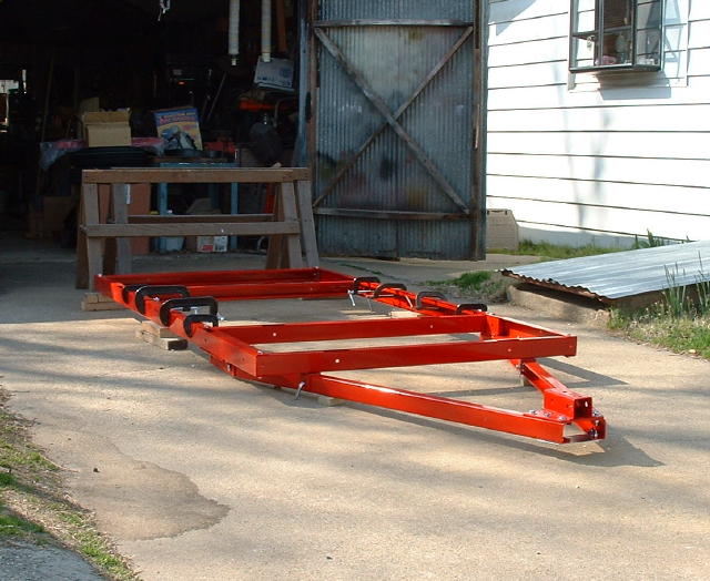

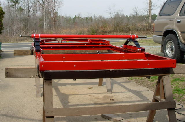

I assembled my HF 1800# trailer completely alone in 2006 (I was age 66 at that time) using blocks & sawhorses. Instead of building it in two sections as the instructions showed, I used the 2 cross members where the 2 halves are joined, as 'inserts' inside the side rails to provide extra strength there (replaced those 2 pieces with a wood 2X4 after the chassis was assembled). Also moved the axle/springs assembly back about 4" so I'd have improved backing/tracking after the cabin was built. Lifting one side of the chassis wasn't difficult to lean it on the sawhorses for final fastening. I clamped longer 2X4s to the sawhorses & lifted one side at a time after the chassis was upside down (flipped) to install the axle/springs assembly... After assembly as above, I modified the tongue for strength & to add more length between coupler & axle, also to improve handling, especially while backing. Added BAL stabilizer jacks for leveling/stability during cabin construction.
