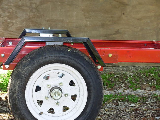

Picked up the new HARBOR FRIEGHT chassis for the "Foam Duck" yesterday since I had a 20% off coupon. Got it, including taxes, title info sent to DMV, and all for less than $370. They wanted $369 BEFORE the add on. Think it was a good deak. Especially after I got it home and found out the new ones have a 5 (YES F I V E) lug pattern AND a grease fitting in the spindles. But that lsst part begs the question: after cleaning the bearing, can I put everything back together and then 'over fill' the hub to pack the bearings? Also what about using whie lithium grease in the hub? Not trying to be lazy, but I am 70, and busier that a one armed Vegas bandit on a hot Sadturday night with the DW being sick nowadays.

etrailer grease guide
That includes a label markings explanation. The grease has to have the proper grade marks to be used for wheel bearings.
Personally I would load the bearings with grease before assembly rather than trust enough grease got into the actual bearing by force feeding through the grease fitting. But that is just me and because I've always done it that way. Well, and because I have one ofthese... HF sells one a little cheaper
And a FYI / heads up.... when adding grease to something previously lubed, not all greases are compatible. Bottom of that link has a compatibility chart

The semi-clear stuff that is on the HF hubs is not "grease", but is a packing compound. In multiple areas of the instructions you will find that you must repack the bearings. I'm old school and hand repack all bearings on every vehicle I have. I also do it every 3-6000 miles. I prefer the red grease, but any good axle grease will work. Fully filling the interior of the hub is actually a bad idea as it tends to retain heat at a much greater level. I know a bit about doing stuff like this, as Jr. Johnson taught me as a teenager on how to build race cars.

daveesl77 wrote:The semi-clear stuff that is on the HF hubs is not "grease", but is a packing compound. In multiple areas of the instructions you will find that you must repack the bearings. I'm old school and hand repack all bearings on every vehicle I have. I also do it every 3-6000 miles. I prefer the red grease, but any good axle grease will work. Fully filling the interior of the hub is actually a bad idea as it tends to retain heat at a much greater level. I know a bit about doing stuff like this, as Jr. Johnson taught me as a teenager on how to build race cars.
dave
REREAD THE ABOVE POST !
I worked two years in a lubricants lab and all the above is absolutely correct. Look for " E.P." on the can (extreme pressure) for wheel bearing applications. I personally like the graphite and molybdenum disulfide fortified greases. White lithium is not normally E.P. rated. It is used on light loads like door hinges and locking mechanisms. A can of good E.P. rated wheel bearing grease is $4.00 +/-. Is it really worth the risk !

I agree with all the above but the mileage interval of the repack.... You probably can go 20,000 miles on a well done hand pack with good grade of grease....

I agree with Dale that repacking at 5,000 or so miles is not normally needed and 20k would normally be fine. I do it because I got into the habit so many years ago and just stuck with it. Once you learn how to do the old grease in the palm, squish through the bearings, it is kind of a zenlike experience. Plus I can drive my wife crazy by acting like I'm going to sit on some furniture with axle grease all over my hands. :D

Werdahekrwe wrote:I got it home and found out the new ones have a 5 (YES F I V E) lug pattern AND a grease fitting in the spindles.
That's interesting, because the one I brought home yesterday had no grease fittings. It took me about 1/2 hour to buy though as they couldn't find it in the back, and what's funny is that there's about 6 different SKU's for these trailers.

My HF 1800# (now 1720/40 I believe) bought in 2006 came with 5 lug wheels?? No zerk fitting in the spindle, tho it did come with 'bearing buddies' which I use strictly as spindle cups, have never pumped a speck of grease into them.

I will say - and I know from experience from trying today..
Buy spare wheel bearings and seals.
I live in a decent size town with places like Tractor Supply and even a Camping World, in addition to AutoZone, Advance Auto, and a CarQuest distribution center with a store attached among others. Heck, even have a HF 2 miles from the house.
There's no buying spares locally, so if you break down on the road you are going to be waiting. I actually was hunting for seals because of the dimwit HF assembling the hubs and supplying the instructions to repack the bearings after the fact (srsly?) but let me tell you they are not to be had. I can go into Tractor Supply and buy a complete axle for $100 bucks but a grease seal? Not for the HF trailer. Buy spares folks. Yeah, I know I can pop the seals to regrease, but Murphy and all that..
