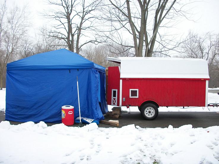

Postby bobhenry » Wed Aug 05, 2015 9:04 am
Mine was a 5x8 Namco looks exactly like the northern.
The second cross member was bower downward from being overloaded. Indicating to me there was a need for a better tongue design.
Here is how I made it to 10 foot for the barn
viewtopic.php?f=48&t=30307
Re: 10' build on a NT 5x8 trailer
Postby bobhenry » Wed Aug 05, 2015 9:26 am
The added length proved to be a bit ambitious for the 2x2 sq tube and a repair was needed.
After some brainstorming we added a flat strap and a small post to the front frame member. If you look closely you can see them in this picture...
as the coupler accepts more weight the tendency to lift is controlled by the forward strap and transfers the lift to the frame front member and tensions the rear strap for assistance. It has essentially made a truss out of the straight tube tongue.
