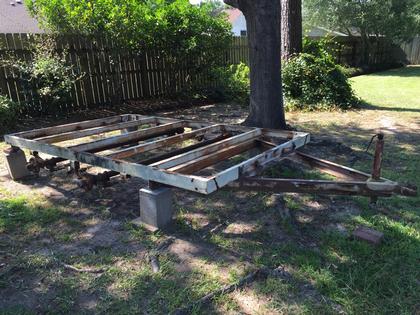

I realize I am breaking protocol by asking questions before introductions but I am crunched for time and forced to just jump into the conversation. I have access to a 10x6 tandem axle trailer frame. I have not even inspected it yet to see if the bearings turn but the price is too good not to consider it. To my question. Is two axles one too many for a 10ft frame? Weight is not an issue. My tow vehicle is a 3/4 ton Chevy. Thank you all in advance.

That looks like it could be a fine chassis for a stand-up once cleaned & painted. Two suggestions that in the end might save work & expense;
Replace the axles & springs with a single bolt on torsion axle with the correct load rating and brakes. There are 'stickies' above in this forum that explain how to do it.
And wait to order the axle until your trailer is built to the point where you can determine weight & balance.
Fred

Well.... For $200 I couldn't pass it up. I pick it up tomorrow and begin my planning all over again. Heck, if it doesn't work out as a camper frame I will build a barbecue trailer and start competing.
