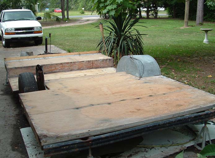

Incidentally, I have a steel trailer, from a 1970 or so Aristocrat LoLiner of the dimensions I want to use. It has a drop floor area. I hate it. I'm trying to get around using it.
