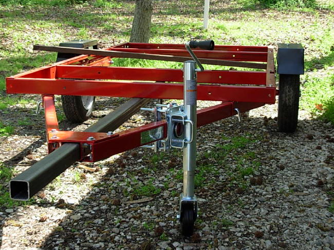

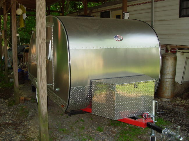

Alan, I built my TD in 2006 on an HF 1800# 4x8 trailer. Couldn't abide the 'clunky' 'A' frame tongue & also needed more tongue length so I devised an extension. My tongue extension extended 18-20" forward of the 'A' frame & I used 2x2x3/16" material for the extension. For more'n 10 years & nearly 30K miles over every kind of road/terrain imaginable we've had no problems with tongue strength. My tongue weight is generally under 150# but may go near 175 if the tongue box is heavily loaded. Our TD 'cabin' is 60x114x53.5" outside dimensions, & weighs around 1150# loaded for travel. We currently tow with a 2008 Toyota Tacoma, 4L V-6, 4x4, auto trans, 4-dr P/U with a 'hi-rise' camper shell on the bed but started with a '95 Nissan King Cab hardbody 4x4 P/U w/2.4L 4 cyl & 5spd trans. If your tongue extension doesn't extend more'n 24" or so, 3/16" metal thickness should be sufficient. I also used 2x2" angle bolted between the front & second cross member, & bolted the tongue extension crosswise between those so it didn't have to be bolted vertically through the cross members. Dunno if that contributed to strength or not but I liked it better & had the material available so that's the way I did it. Also 'ran' my TV/trailer elect wiring through the tongue extension to exit under the trailer frame where I continued it to the tail/brake/turn signals & running lights using 'corrugated' plastic loom materials for protection.

Nobody wrote:Alan, I built my TD in 2006 on an HF 1800# 4x8 trailer. Couldn't abide the 'clunky' 'A' frame tongue & also needed more tongue length so I devised an extension. My tongue extension extended 18-20" forward of the 'A' frame & I used 2x2x3/16" material for the extension. For more'n 10 years & nearly 30K miles over every kind of road/terrain imaginable we've had no problems with tongue strength. My tongue weight is generally under 150# but may go near 175 if the tongue box is heavily loaded. Our TD 'cabin' is 60x114x53.5" outside dimensions, & weighs around 1150# loaded for travel. We currently tow with a 2008 Toyota Tacoma, 4L V-6, 4x4, auto trans, 4-dr P/U with a 'hi-rise' camper shell on the bed but started with a '95 Nissan King Cab hardbody 4x4 P/U w/2.4L 4 cyl & 5spd trans. If your tongue extension doesn't extend more'n 24" or so, 3/16" metal thickness should be sufficient. I also used 2x2" angle bolted between the front & second cross member, & bolted the tongue extension crosswise between those so it didn't have to be bolted vertically through the cross members. Dunno if that contributed to strength or not but I liked it better & had the material available so that's the way I did it. Also 'ran' my TV/trailer elect wiring through the tongue extension to exit under the trailer frame where I continued it to the tail/brake/turn signals & running lights using 'corrugated' plastic loom materials for protection.
That's a good picture of what I plan to do. I will be inverting that top plate like you did and running the tube through it to connect at the A-Frame. I will then be running back and connecting to the first and second cross-members.
