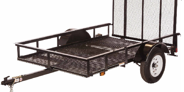

Tractor Supply has this on sale for a couple of more months for 599.00. Best deal I could find in this part of FL. Tongue is bolted but pretty strong, a little short at 36", but not bad.
2"x3" tongue, 13" tires and weighs 400lbs. Tailgate is maybe 80lbs+, which I will remove.
I saw a TT that left the rails on and there is a build here that took off the rails and mesh. I bought one and have towed it with about 1500 lbs of stuff on it with a 4 cyl Honda Element. I like it so much I will keep it for hauling and get another for my TD. So much for staying on my modest budget.
