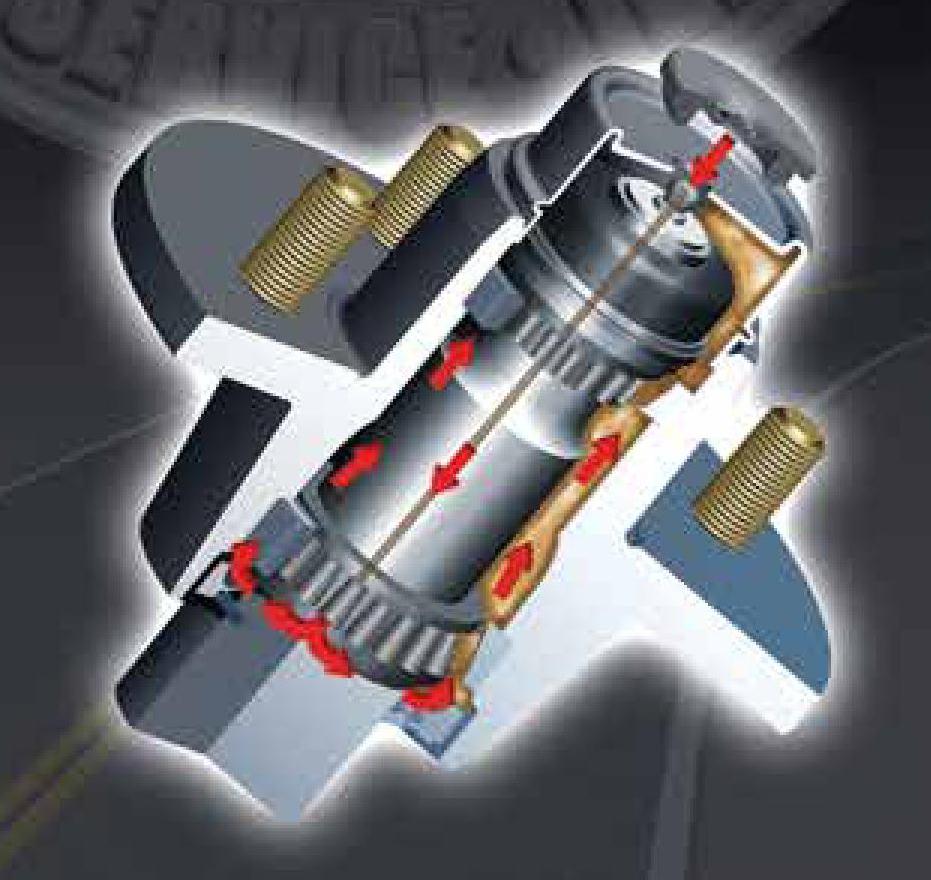

This axle has the the EZ lube grease zirk on it too. Not a big fan of those since it seems it would be easy to overgrease. Any $0.02 on those?

EZ-LUBE axles force grease thru the center of the spindle to a point in the rear portion of the hub where it then makes it's way thru the rear bearings outward thru the outer bearings and into the dust cap which has a rubber center plug
when you have filled the hub cavity grease will ooze out of the hole that the rubber cap covers and both bearings will be properly lubed while there is no room in the hub cavity for foreign material(dirt or water)

The problem I experienced with easy lube axels, when you grease them you lose the space for heat expansion. Then you have grease going all over. So, I greased my hubs until clean grease came out. Removed the cap first, cleaned all the excess I could. Installed cap, went for a 5 mile drive. Removed the cap again, cleaned excess, reinstalled the cap. No more mess!!

dmdc411 wrote:The problem I experienced with easy lube axels, when you grease them you lose the space for heat expansion. Then you have grease going all over. So, I greased my hubs until clean grease came out. Removed the cap first, cleaned all the excess I could. Installed cap, went for a 5 mile drive. Removed the cap again, cleaned excess, reinstalled the cap. No more mess!!
good idea. I didn't account for the expansion and had a bit of a mess after a 2000 mile cannonball run pace of trip. stopped to check for wear and heat, but not to clean stuff up. It is amazing how grease can spread and splat and coat EVERYTHING on a spinning wheel.
me thinks you don't understand why the hub cavities are supposed to be kept full :thinking:
keeping the hub full prevents water intrusion
water & bearings are not friends
if you are worried about the mess just wipe the excess off every now n then :thumbsup:
