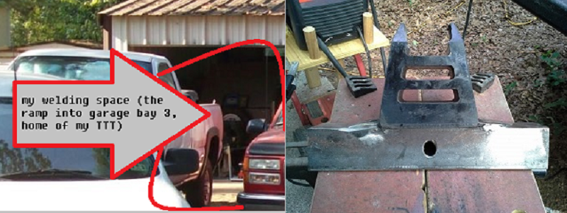

Me too. Actually, all of my welding has been outside, where I can see any stray hot metal and douse it immediately with the garden hose. I've got three sheds (full of junk collected by my wife), and the three bay garage (full-up with automotive gear & parts, my TTT, my Chevelle, and one bay usually filled with furniture, as I am re-building the rafters/joists one room at a time). I wait until the south breeze dies down, close the trailer bay door, and weld with the wind blowing toward the closed door. Somewhat limiting, but that's the method, so far. My Northern Industrial (Northern Tool) 110v flux-core welder is probably similar to the HF model, but never seems to reach its duty-cycle limits, and I'm pleased with it. It is a stand-in for a Northern Industrial 220v stick welder, until I get better 220v wiring to my garage. But, still, I need to set up a safe space to weld anyway, before going to a bigger, better welder, and large projects.
limited welder, limited space, limited projects.png (436.32 KiB) Viewed 1379 times
