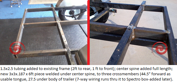

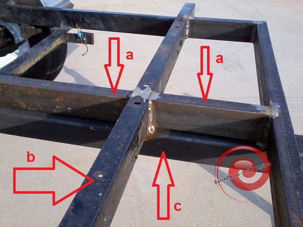

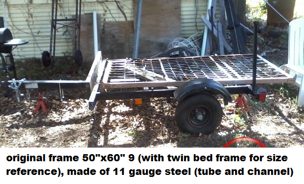

  • Maybe not the same thing you are looking to build, but I was aiming for a "light", under 1000 lbs, trailer, to pull behind a HHR or Cobalt. But, I always had as a long-term goal, to make it durable, above all, for future usage in moderate off-road venues. But things got a bit out-of-hand, as more ideas came forward, along with increasing weight.
  • I started out with a small, undersized frame (probably under 150 lbs), composed of 11 gauge tubing and c-channel. I added 1.5"x2.5" tubing (front 12", rear 24") to enlarge it to hold my 4'x8' floor, to start. I welded in a central spine running full-length front-to-rear, for floor support, longitudinal rigidity, and as a "sister" piece for the 3"x3"x.187" tubing welded in under it as a single drawbar.
  • With a beefed-up steel frame, and the 8" wheels converted to 14", just adding a 3/4" floor brought the weight to 400 lbs; without yet starting on the upper structure, I knew it would never end up a lightweight.
  • The trailer frame, with a "torsion box" structure above, and a central spine of tubing below ('not to mention the tongue is welded to three crossmembers), has survived an airborne incident without bending or cracking, so I am glad I added all the extra steel, instead of just building over the original frame, with just plywood. Made it a bit heavier, but definitely stronger.
    original frame.png (397.42 KiB) Viewed 1352 times
    it stayed 50" wide, but length extended to 96"; tongue replaced with longer & stronger piece
    tubular steel for added length and strength.png (298.59 KiB) Viewed 1352 times
    different types of steel used in frame.png (498.49 KiB) Viewed 1352 times
    a) 1.5x2.5 tubular, b) 11 ga c-channel, c) 3x3 square tube (6 ft) welded under
