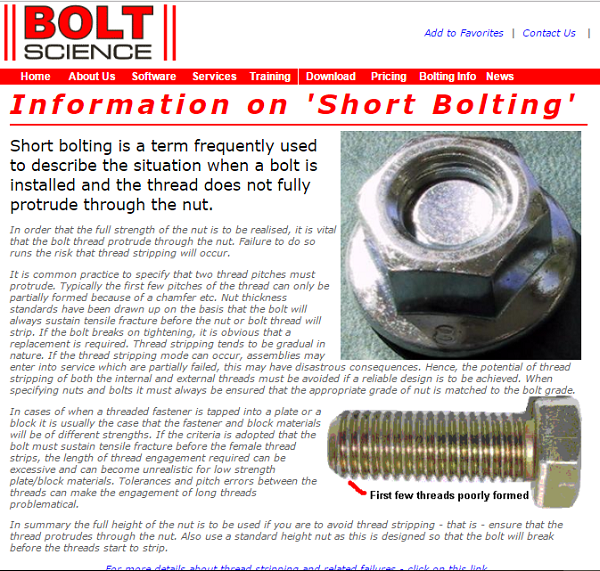

  • A word of caution-I think I see a future problem awaiting you; your fabricated square u-bolt is not long enough for secure fastening, and the threads of the bolt-legs may pull thru the nuts, at some time. The threads should penetrate the nuts to "at least" the top of the nut, and preferably pat it. The flat washers are not helping in holding power, keeping the bolt threads from engaging the crimped top of the locking nuts (I assume that's what type the are).
  • I'm not a mechanical engineer, either, but after a lifetime of bolting just about everything together, including race-cars, multi-million dollar newspaper production & distribution equipment, metal structures, kid's toys, and my TTT (used bolts/steel brackets wherever possible; favored by me over pocket screws, biscuits, and blocking methods), I've learned about using the proper (minimum length of bolt-thru-nut thread engagement. Always use all the interior threads of the nut to get maximum holding power. In drag-racing, they inspect your wheel studs to make sure they go fully past the nut.
  • from NHRA 2007 Rule Book, Section 16 General Regs wrote: "The thread engagement on all wheel studs to the lug nut, or lug bolts to wheel hubs, must be equivalent to or greater than the diameter of the of the stud/bolt. Length of the stud/bolt does not determine permissibility. (Example: A 7/16-inch stud must be thoroughly engaged through the threads in the hex portion of the lug a minimum of 7/16-inch.)"
  • Though the rule may not be strictly enforced at all tracks or for all classes, you can bet that the higher-horsepower cars are looked over, and the fastest Sportsman classes must even increase the wheel stud size to specially-made 5/8" bolts. Part of the reason for this is the rounded-off or incomplete threads at the end of a bolt/stud, so the inspectors want to see that the nut' threads are fully engaged, for strength.
  • Here's a snip from the website Bolt-science http://www.boltscience.com/pages/shortbolting.htm, describing why short-bolting is avoided, in standard practice, though there seems to be no single standard shared among many professional associations.
  • I like the idea of having an angle bracing/holding your tongue piece, I use similar u-bolts and angle iron for clamping power on my trailer, too, but I always make sure I have extra length of threads showing past the nuts, for surety of thread engagement. I often use double-nutting, or lockwashers+nut+nylock, to ensure the bolt not stripping thru as easily. And on vital parts, like my axle u-bolts (made of tougher stuff than most u-bolts), I always torque the special nuts for the same reason-you'll never see a manufactured truck or trailer without the u-bolts showing extra thread.

I am a mechanical engineer.
Rule of thumb is that full strength is when all threads in a standard hex nut ( or the same thickness in a tapped hole) are engaged with the screw.
The fastener looks halfway thru the hex nut, so my first guess is it's half strength.

Postby Glenn Butcher » Sun Apr 02, 2017 5:01 pm
Ah, meant to type something about that, forgot before I posted.
The picture shows a "loose fit". When I torque them down, there's about 1/8" of thread above the nuts. I may go and get them to cut another pair for a bit more clearance. Thanks for the vigilance, though, really wouldn't want anyone to think that the situation in the picture is okay.
The whole thing's apart now, under a tarp. Work gets in the way of progress... :D
