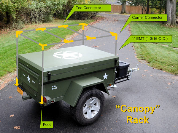

  • I don't know what your plans are for camping in your trailer, but if I were in your position, I would use the 3" of additional space along the sides of your shell (if centered on the frame) for one or both of two things:
  • 1) external side storage- by bolting on steel or aluminum plate to extend the area, you could carry water, gas, propane tanks, your spare tire, and extra gear, without having to store them inside the trailer or tow vehicle-everyone always needs extra storage sometimes-, and
  • 2) externally supported, free standing rack-I've struggled to find a way to either carry more gear on my trailer, or to create an awning or tarp system, without spending hundreds of dollars experimenting, and drilling dozens of holes into my shell (extra holes=more chances for leaks); I finally decided to just use canopies, since too many holes was not an option. But, is I had a 3" space running along both sides of my cabin, then I could've made a free-standing rack/framework over the top, to be used as either a rack, or as a frame fork tarps or awnings over the trailer. No holes need be drilled into the shell at all. Another benefit, if going off the beaten path, would be protection from tree branches or bushes from impacting the shell itself (if the framework is sturdy enough). I am still considering doing something like this, sometime in the future, though I only have an inch of trailer frame exposed (I might have to weld extensions on, for the framework footing).
  • I saw this web page awhile back, when I had given up the idea of an awning framework, and already bought a second canopy, and constructed a small rack on my trailer front to carry them. As proposed by J.Scherb, an inventive member of several forums dealing with camping, outdoors, trailers, etc., it was a simple solution that I had not thought of before...I had always attached the parts (practically the same ones) directly onto the cabin, by drilling many holes, not as a free-standing structure. https://tventuring.com/trailerforum/thread-356.html. Here is a photo/drawing shown as an example
    CanopyRack1 by J.Scherb.png (679.21 KiB) Viewed 1254 times
    shown on a small off-road trailer, this could be enlarged to work on a larger TD, or TTT trailer
  • This might not fit in with your plans, nor with your aesthetic sensibilities, but I envy the extra trailer floor space you have, which could readily address my storage and awning problems.
