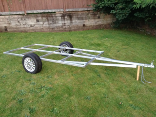

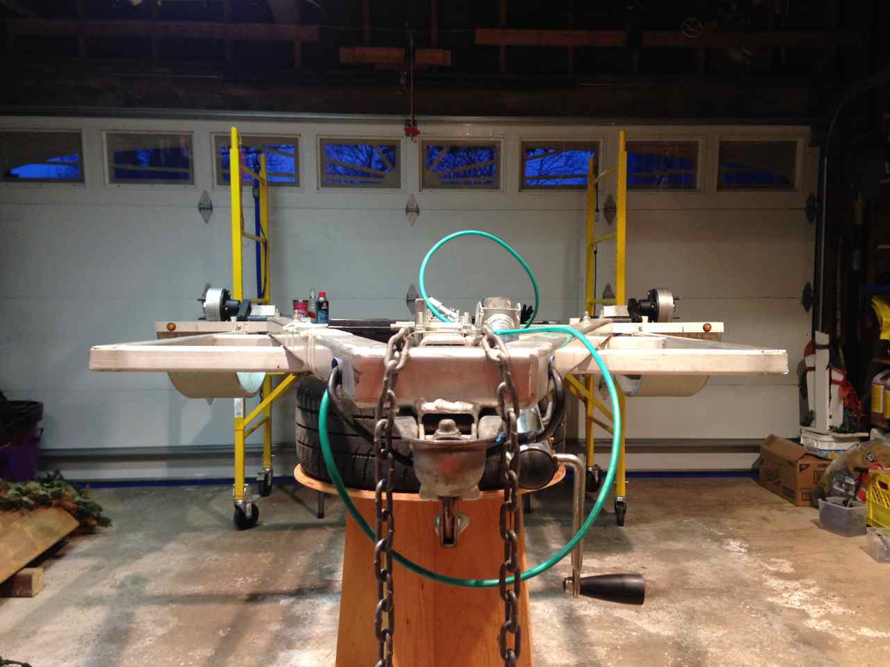

Today I checked the toe-in on the trailer setup for the first time. I measured three different ways, on both sides, averaged the results, discarded one bad one. The point is this trailer has half-axles, so the question is still relevant for full axles too, but I should clarify that the half axle mounts are still fully aligned at zero degrees on the raw frame (trailer might have 10kms on it so far).
Now I noticed just looking at the tires the other day that the drivers side tire was toed-in. Really I wonder, so I check the mounts, and the trailing arms and they are square. Its the hub stubs on the half axles, they are not square they toe in [Edit: they appeared to toe-in, in fact they don't see below]. I calculated the drivers side toe-in at 0.72 degrees, the passenger side at 0.65 degrees. Is this supposed to be? When we welded up the half axles, we did them square to the brackets, not the hubs.
So there is a static toe-in on this trailer [Edit: it appeared from rough measurements], I just looked up a site that said a bit of toe is good. Can someone back up that statement for me, or whether 0.7 degrees is too much and the half axles need to be re-mounted? These are Flexiride 930lb adjustable spline half-axles.
Here is a pic of the trailer:
the stripped down version of the trailer

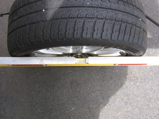

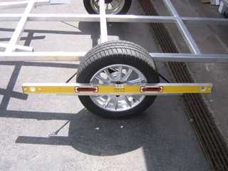

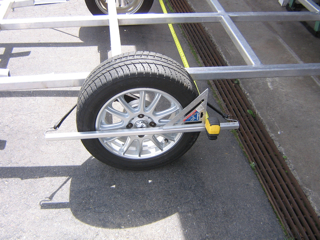

Toe in causes whatever it is to drive straighter. Zero toe causes a little wander, toe out causes a lot.
How are you measuring toe? The amounts your talking will scrub those tires away in no time i believe. If you dont want to reweld then you should be able to use plastic toe shims. Do a google image search for them. Problem is you have to know how much you want to change your toe before you go buy some.
This is how i measure toe. Image

You can do it off the grooves in the rubber, but most tires have at least some runout, some tires have a lot. So its a bad way to measure down to 1/32 of an inch since ive seen tires with almost an inch of runout before, lol.
Measure a few different spots if you do it by the groove in the rubber. As in measure, roll the tires, measure, roll and measure once more to get an average.
With either method spin the tire in the air and take chalk and slowly move it closer to the tire as its spinning. The chalk will mark the spots on the sidewall that stick out farther. Dont measure off those spots...

Ok, I tried my best to do a similar setup without the jack-stands and the string. I used 1" tube aluminum pieces positioned centre-line on two opposite studs, then with a level I rotated the tire until it was level. Then I did the same to the other side and just went back and forth until both sides were level. Then took two sets of measurements, one on drivers side, and then again on the passenger side. Here are three pics to show the setup for my first (semi) proper alignment measurement:
drivers side centrelined with 1" square tube, then levelled by rotating tire
passenger side centrelined with 1" square tube, then levelled by rotating tire
took measurement by dropping square below the tube and shoring it up to the tape
To my surprise there is no toe-in.. it was 73 27/32" all around. I really tried not to bias my measurements, as perhaps I was expecting a toe-in based on the drivers side axle but even though it looks toed in a bit on the drivers side compared to the frame line, the numbers don't lie. I think I'm just going to repeat the whole process again to double check this measurement, to see if it goes towards the toed-in or the toed-out.

Zero toe is fine, its not optimal for a car but should be fine on a trailer. toe may change through the pivoting of the axle if the hub face isnt flat. It does on some vehicles trailing axles. So your toe may change once loaded down anyway.
As long as the bungee cords werent pulling too hard and the valve stem didnt interfere. Lettering will change your measurements. Measurements should be taken at fromt and back of tire rather than ends of bar that your using.
Also those toe plates i mentioned are a far easier way of adjusting toe than cutting off the axles and making them adjustable.
If it looks out of square the next question is is the axle square to the ball socket?
The toe could be perfect on the axle but the sub axles could be both pointing one way.
Measure from a set point on the ball socket to centre of hub on each side to make sure they are the same. Takes 2 people.

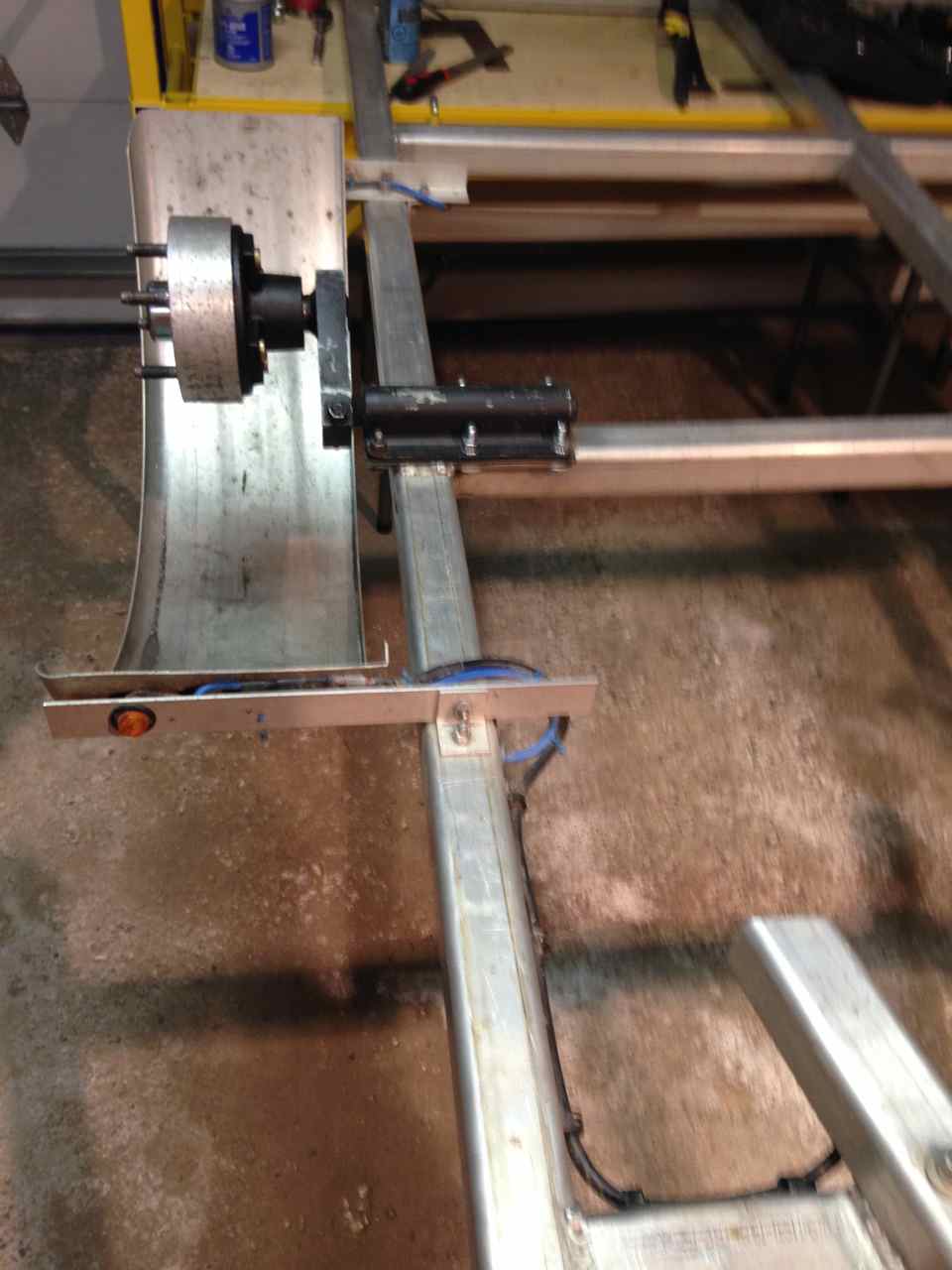

The chassis trailer is undergoing an improving preventative maintenance. The Flexiride 930lb adjustable spline half axles lasted about 22000 kms or about 13,333 miles, at the end being pretty toed out and cambered, thus wearing down the inner edge of the car tires on the last three thousand mile run (no biggie).
Soo it was time coming to do a re-work on the original chassis. LED stop/turn/tail lights were riveted to the 2" rear tube, and an old school incandescent light for the plate. All the wiring was run through the framing - that was the tougher part, learning how to do it better.
The passenger side fender took the most stress. 4 rivets were removed, and 6 more rivets were installed.
The half axles, I thought about it - you know they lasted 22 thousand kilometers overloaded most of the times. So after
wanting the Timbrens, which I still will do, I reluctantly had to admit that I could just buy 'another' set of the same axles, because they will fit.
And then learn to re-align the first set and use them for the ATV trailer I want to make.
From the original pictures - the tongue was shortened, and the main beam was sistered, and an expert TIG welder re-did the front.

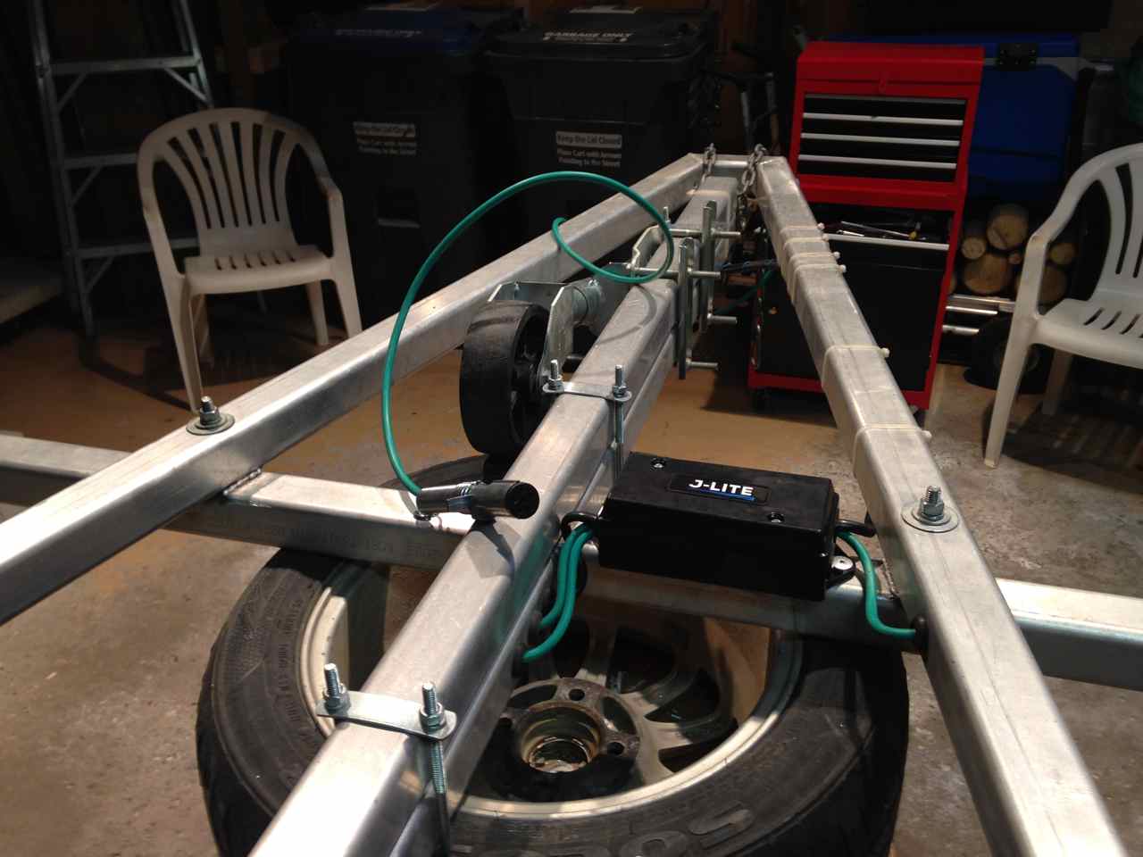

junction box baby - if i could recommend one thing to any trailer wirer - get a junction box they cost like seven bucks
have to re-order those 4 custom u-bolts to safety tie the half axles to the frame... bolts will do 'just for now'
to my original design i wanted to keep this trailer 'really minimal' and it still fulfills this goal - this picture shows how 'thin' it is
