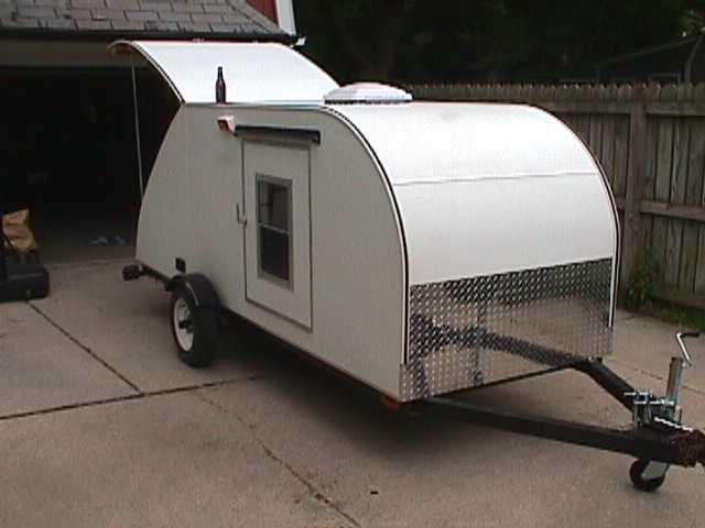

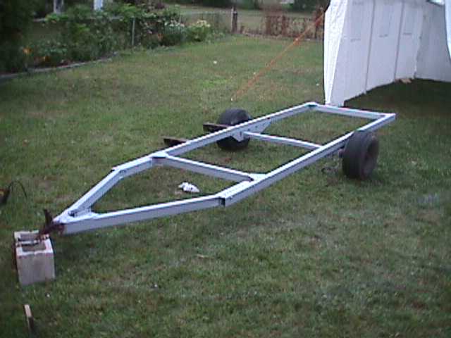

I used an old Apache popup for my frame. It is very heavy duty. Its made with 3 or 3 1/2 inch box steel! My TD is 4x4x12' it weighs 1120 dry . Sure wish I woulda made it 5' wide :cry:

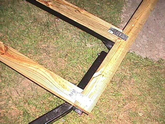

A 2x4 treated base for the floor, bolted to frame
I replaced the 10 inch wheels with 12 inch.
Just how I did it.
Ya'll be cool! 8)
